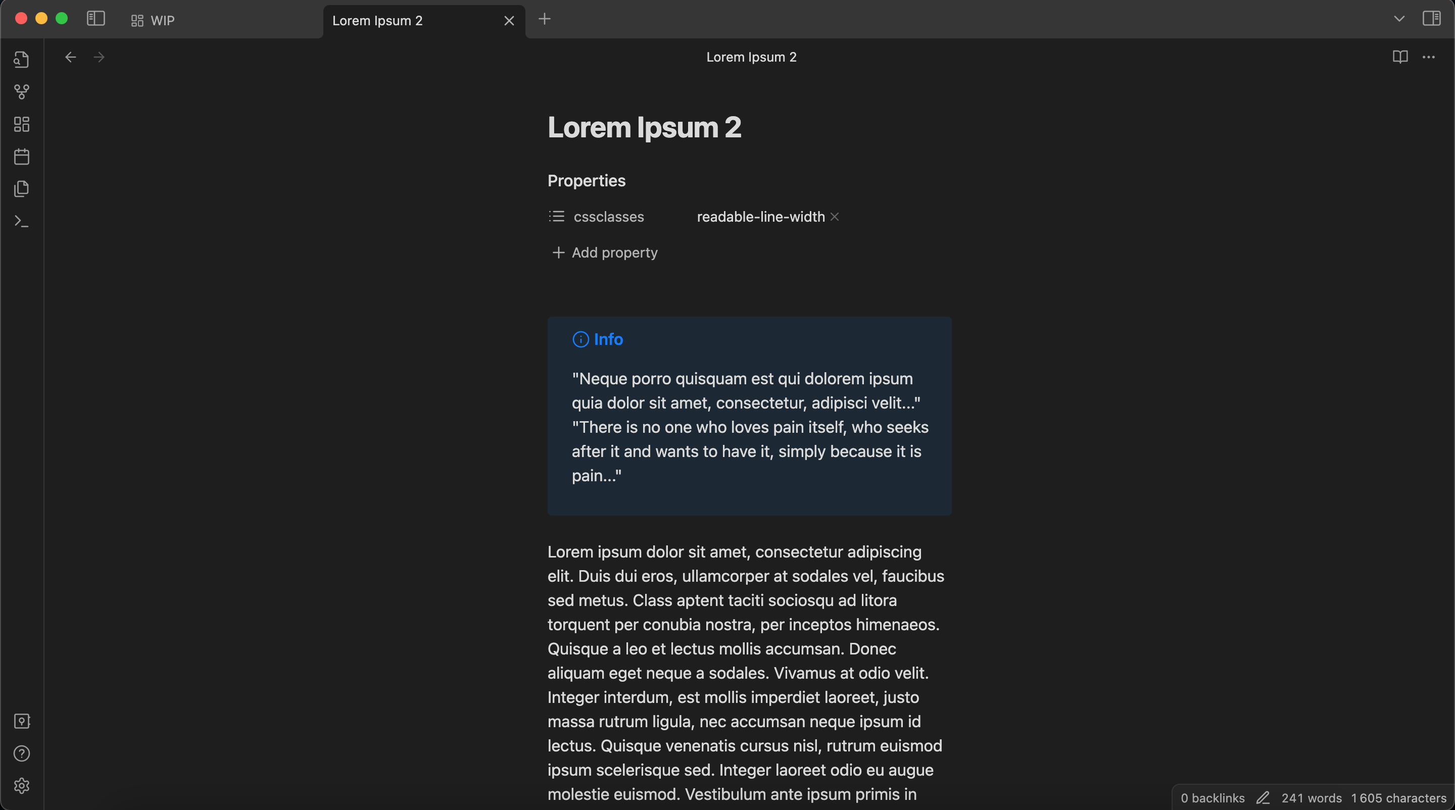

Here’s now what I see when I don’t have a cssclasses in Properties
And here’s what I see when I add readable-line-width to the property cssclasses
Thank you again very much. It actually works as you described.

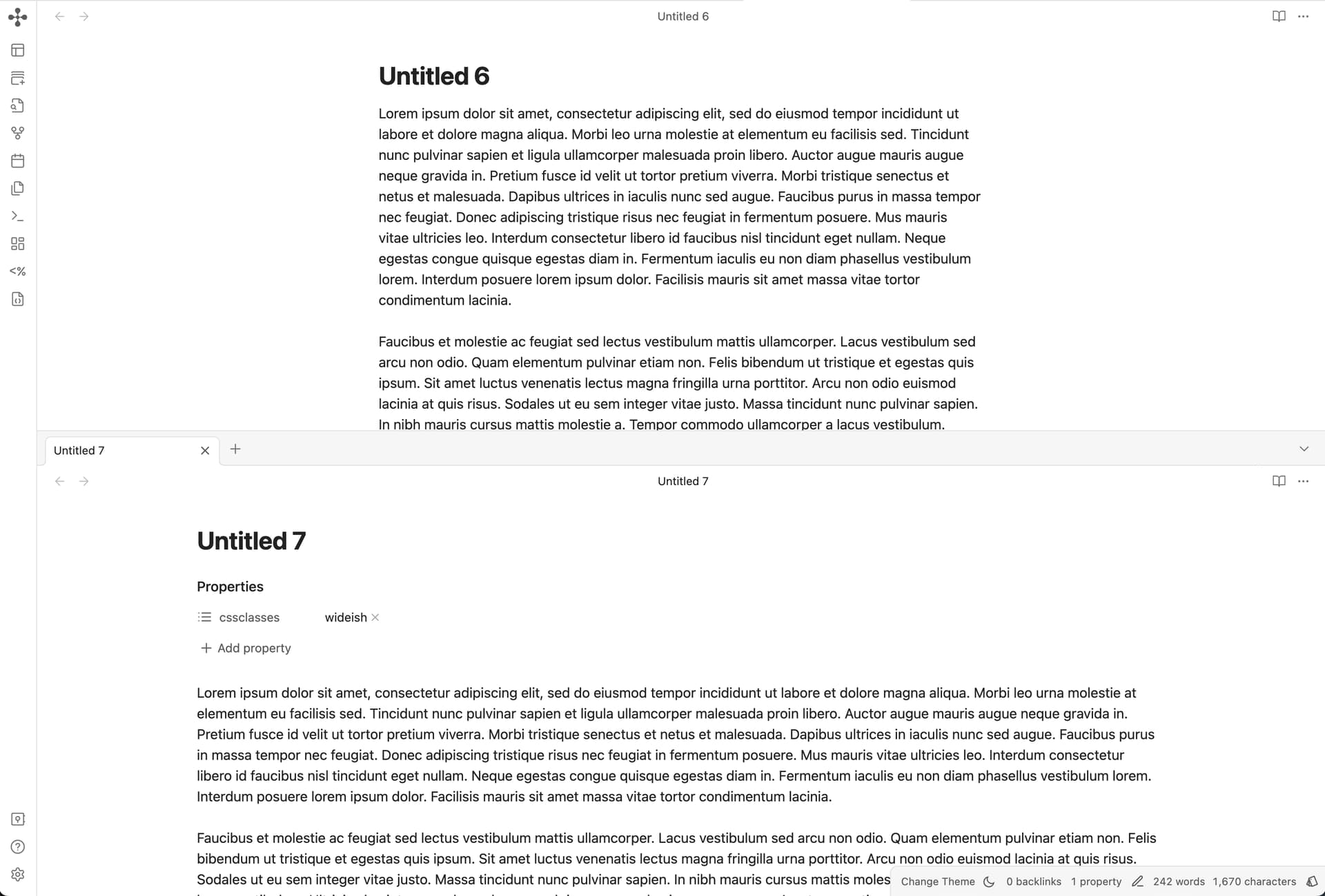

It seems you may have gotten something already, but you could try this as well using only this snippet (with Readable line length enabled in Settings):
.wideish {
    --file-line-width: 70rem;
The value here can also be (e.g.) 1200px or 80%, but % shifts the body text to the left for whatever reason, I just noticed. This will work with almost all themes (not Minimal). Minimal has its own helper classes built-in, but they can be adjusted as well if need be.
All notes will have the readable line length except those with a cssclass of wideish. wideish can be changed to whatever as long as it doesn’t conflict with another cssclass.
