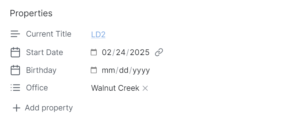

And here is what the property table looks like for each employee:

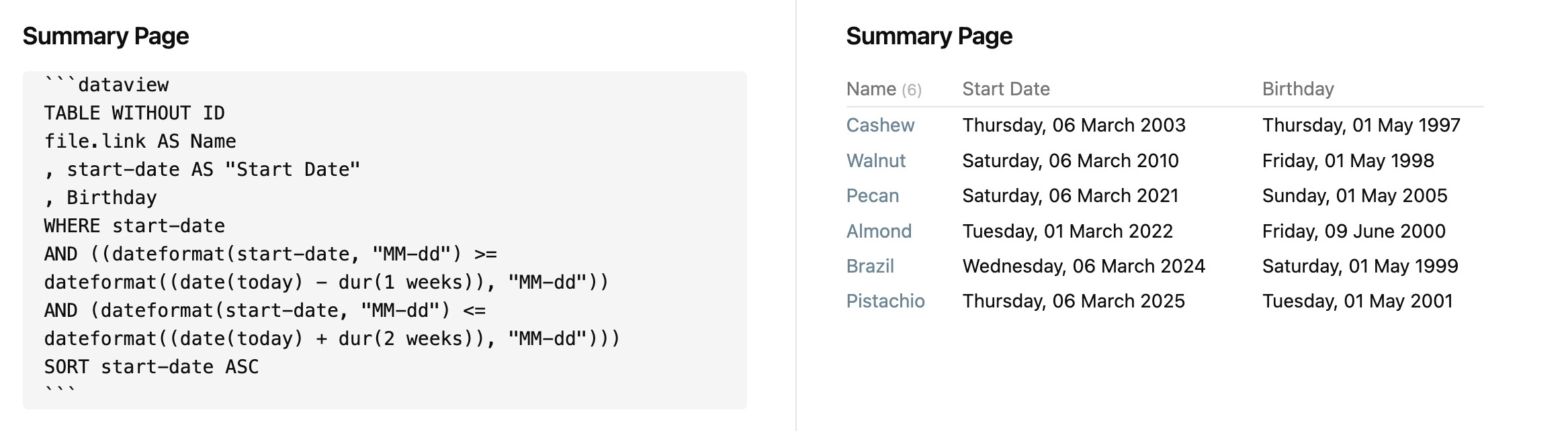

It does. And the query works in my local test vault on a summary page. The original image shows it is pulling data from two sample files. There could be thousands of them and it would (or should) work. Doesn’t work for you? :thinking:
A sample summary page:

So close. Close enough that I’m positive I’m missing a step or I just don’t have enough Obsidian understanding to get it to work. The table is showing up but it’s unpopulated.
Here’s what I’m getting with your query:
It is not reporting an error, which is a good sign.

That might be the issue. The problem is that I can’t change the dates in the metadata properties at the top of the employees file to an ISO8601 format. It defaults to MM/DD/YYYY (see below). And unfortunately the possible code fix you gave isn’t working.
As raw data, are the numbers separated by forward slashes?

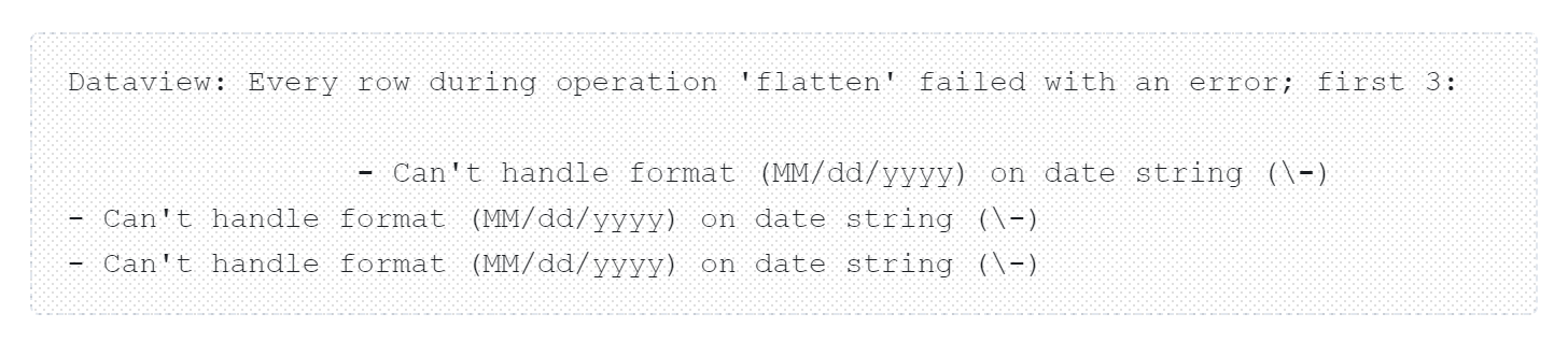

Ah, raw data is in ISO8601 format. Screenshot:
Also, I tried your latest fix and got this message:
