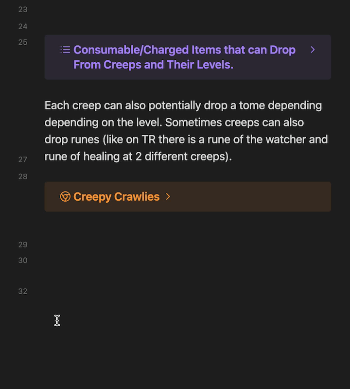

Folded callouts may work for something like this. e.g.
> [!example]- Consumable/Charged Items that can Drop From Creeps and Their Levels.
> Lorem ipsum dolor sit amet, consectetur adipiscing elit, sed do eiusmod tempor incididunt ut labore et dolore magna aliqua.
Each creep can also potentially drop a tome depending depending on the level. Sometimes creeps can also drop runes (like on TR there is a rune of the watcher and rune of healing at 2 different creeps).
> [!success]- Creepy Crawlies

I see… so the only way is to use another tool for that.
I will have to check the differences between Headers and Callouts… as I know, Markdown treats them differently and there are limitations
The link you shared looked similar to callouts in Obsidian, so I thought that might work.
