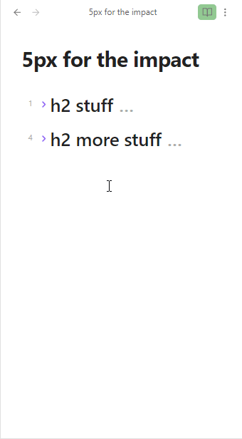

You could try something like this:
:not(.is-collapsed) > h2,
.HyperMD-header-2:not(:has(> .is-collapsed)) {
    border-bottom: 5px solid green;
Obsidian_2IYikBu17S
That’s exactly what i needed, thank you!
