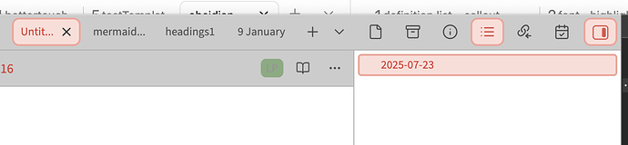

Screenshot 2025-07-07 090433
The above is what the top of Prism looks like with a few tabs open, all default settings, in my vault.

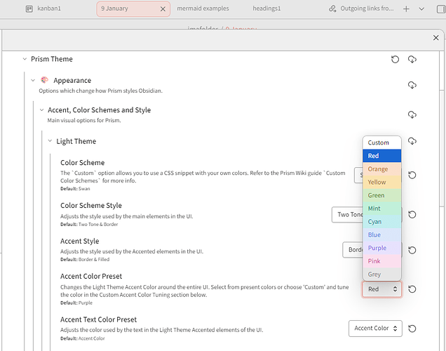

Are you looking to change the tab and accent color used in a few different places? That appears to be controlled from here, the Accent Color Preset.
Ah, okay, I didn’t realize how old the screenshot was. The color I’m trying to change is the gray in your second screenshot. I think Prism just no longer has the ability to customize the part I want to customize without learning more coding that I’m not willing to look into right now lol

That area looks to be set by --background-secondary, so you could change it with this, for example:
body.theme-light {
    --background-secondary: hsl(0, 0%, 80%);  /* hsl(0, 0%, 93%) */
