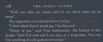

I have a css snippet that inverts a scanned pdf to dark mode (or close enough), originally posted here. The problem is, the snippet works for only about 10-30 seconds after opening Obsidian, then it stops working. If I close and reopen Ob it works again for 10-30 seconds. Has anyone had this happen? I also use Blue Topaz theme. Below is the css code:
.theme-dark .pdf-container:has(.textLayer :first-child.endOfContent) canvas {
  filter: invert(0.9);
Below is how the pdf looks with the snippet briefly active:
After 10-30 seconds, it switches back to this:
Edit: the snippet “switch” remains in the “on” position throughout.
I can’t seem to get your above snippet to do anything for me – looking at the PDF itself, embedded in a note, or in the Canvas.
This is working on my end (without the :first-child.endOfContent part) and nothing changing after a minute or so:
.theme-dark .pdf-container:has(.textLayer) canvas {
maybe give that a try?
It looks like this is working! Thank you so much. Was going crazy trying to figure out why it was turning off after a minute or so.
Another bonus is that the “switch” now works under Appearance → CSS snippets, so I can turn it off if wanted.
Lastly, thank you as well for posting about registering hotkeys for CSS snippets. I was able to set this up to quick switch the viewing of the PDF. Can’t tell you how much I appreciate your help here.
