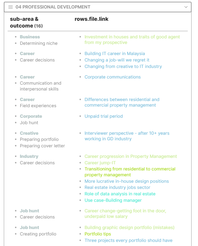

How do I group twice?
Ive read the community posts before resulting to this. I dont have coding knowledge. I just want to group this into two column and i dont know much about dataviewjs.
Is it possible to have sub-area and outcome column separately?
This is the best i can do.
TABLE rows.file.link
FROM ""
WHERE contains(main-area, "Professional development") AND outcome
GROUP by flat(list(join("**" + sub-area + "**"), outcome)) as "sub-area & outcome"
