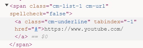

While the html in Editing view is this:
As you can see the links in Editing view have an href="#" instead of the actual YouTube URL. This causes my CSS targeting href*="youtube.com" to not work
It looks like there’s not enough in the editor to target individual links with CSS (the second screen shot).
If I wanted something like this, I’d give Regex Mark a try:
