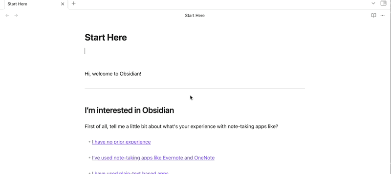

This looks fixed in v1.8.6. Clip from the Sandbox vault.
CleanShot 2025-02-15 at 14.33.33
will be fixed 1.8.8. No ETAs.
