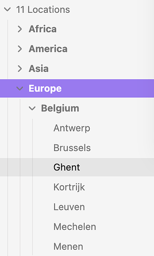

Location File Tree:

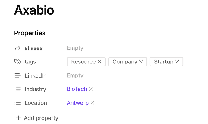

Company Properties:
The files with #Company are not in the locations folder but in a separate one.
Now I used your suggested Dataview query in the Europe folder note and it just returns me all files with #Company, I only want the ones that have a location linked that is in Europe or Europe itself
