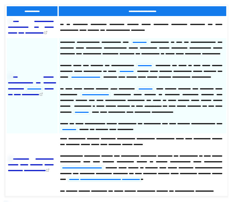

Screenshots
Narrow table

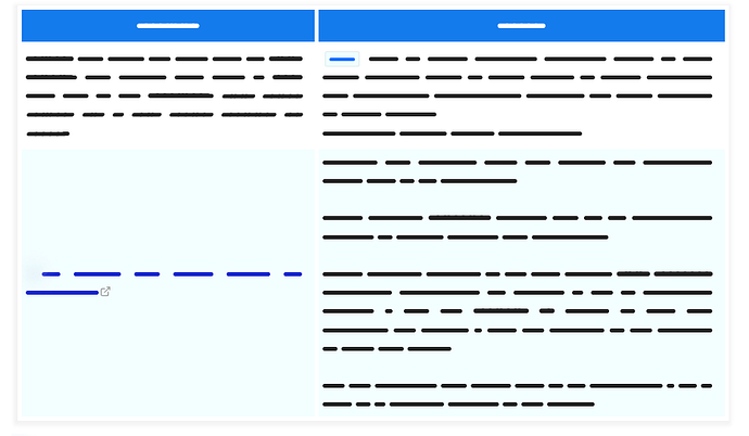

Wide tables with multi-line content

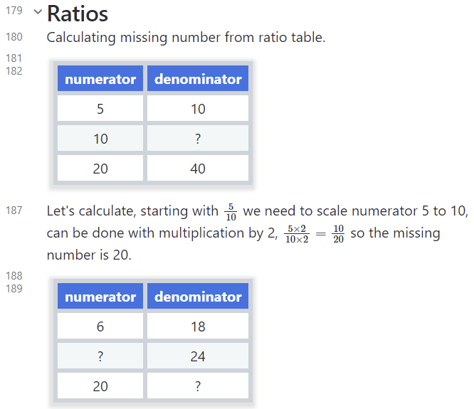

Hey @kazzy respect for them CSS theme idea, here is the fix which works with dark mode too and less blurry (my tables were blurry initially)

Hi @Samo , thanks for your css however the only issue I see with this is if you have several tables in a row, it’s impossible to put the cursor between two tables should you have to add some text there.
A workaround is to go to source mode, but it’s a bit cumbersome.
Any idea how to solve this ?
