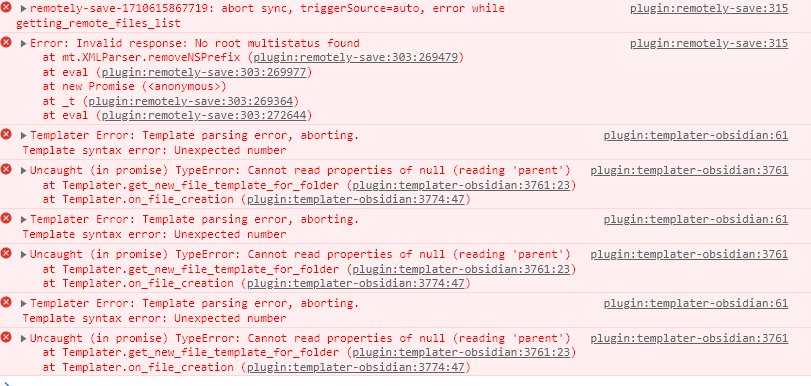

I believe the main error showing in the console is: “Uncaught (in promise) TypeError: Cannot read properties of null (reading ‘parent’)”
I need some help 'migrating these to the update version of Obsidian and will greatly appreciate any help.
Which errors are you getting exactly? Because besides syntax errors or something like that, I don’t think there should be any issue keeping them as they are.
I get a ‘Template Error: Template parsing error, aborting. Check console for more information’.
I’m not sure which specific error in the console to address.
