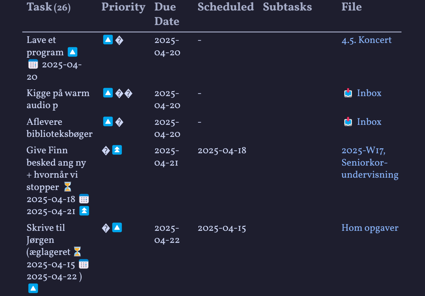

Im’ trying to make a table that shows my tasks, where I can see both prioritation, due date, etc. And can filter for this weeks tasks.
With the help from google and this forum I have gotten to this query, and it kind of works,
but there are som weird question marks, and I can’t seem to figure out how to filter for this weeks tasks only:

Thank you very much. Can you also figure out, why I get those strange question marks in my prioritation row?
It appears as if you’re getting one question mark per :date: and :inbox_tray: icon. And perhaps other icons. If you have this task:
- [ ] task 1 📅 [due::2025-04-22] 🔼 📥
… does the priority show “� :arrow_up_small: �”? Then paste “:joy_cat::joy_cat::joy_cat:” into the task to see if you get three more question marks.
If that’s the case, then someone who knows more than me about regex and/or icons in Dataview might be able to figure out a solution for that. Maybe get those folks’ attention with a forum post title about specifically that.
You were so very right. it acted exactly as you proposed.

You could try selecting a different font. That symbol can show up when the font doesn’t support certain Unicode or Emoji characters.
Possible to identify and filter the emoji out?

The emoji is from the task plugin itself, so I can’t filter those out, unless I change the style of my tasks from the emoji style to the dataview style, and i would prefer not to. I didn’t get any further from the other post, unfortunately
Now i have tried differnt fonts and themes and nothing seems to change

I don’t use Tasks so can’t test, but since that regex statement isn’t replacing all icons, then use a different method. You can try this one with choice:

That is really clever. Tried for a couple of hours yesterday to get choice to work but couldn’t. Genius. Thanks for sharing. :clap: :clap: :clap: :purple_heart: :star_struck:
