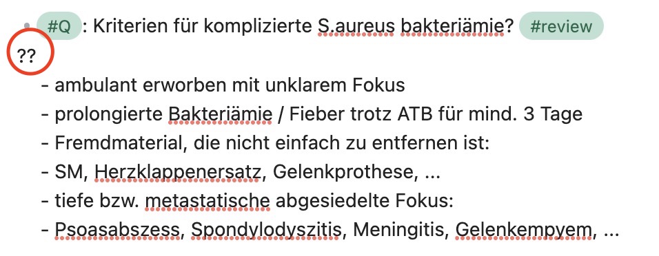

Before I knew about flashcards plugins (as the popular “Spaced Repetition”) I used my own “archaic” system:
  • all questions start with “#Q” and end with a question mark “?”
  • answers are all indented bullet points
  • questions I had difficult with were also marked with “#review” at the end.
Example:
With this I built around 1000 “#Q” questions (1 note per theme with several questions within that note) and some hundreds “#review”.
Now that I discovered the plugin Spaced Repetions I’m trying to adapt my “archaic” system to the plugin and I managed to figure out how to do it:
The problem is, I’d have to manually update all the questionsby adding a “??” between the question and the answers (as in the above printscreen). Is there a way to automate that? Or another plugin that better suits my archaic system?

I don’t think there’s a way in core Obsidian. You could use the Regex Find/Replace Community plugin to find (\?|#review)$ and replace it with \1\n??. (In more readable terms: “Find ? or #review at the end of a line and replace it with itself followed by a newline and then ??.”)
With that plugin you’ll have to do this once for each note. There’s a plugin now that does global search and replace, but I haven’t tried it and don’t know if it supports regular expressions. You could also use an external text editor.
