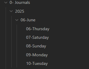

Hello. I’m trying to make habit trackers that take the data from my daily notes. My journals organization is as follows, the folder name is 0- Journals/{{date:YYYY}}/{{date:MM-MMMM}} and the note name is {{date:DD-dddd}}.

I’ve tried changing the folder for each specific month; i’ve tried following results from other people from this forum, discord and reddit; i’ve tried remaking it and following some youtuber; but in the end there are always some error that i can’t seem to solve.
The error that i’m getting now is “No valid date as X value found in notes 5 files are not in the right format.” I suppose this error is because i can’t find a way to change the journal-date property in each note.
