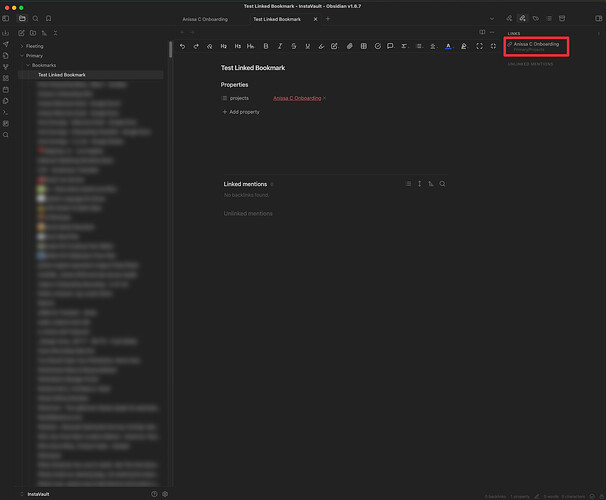

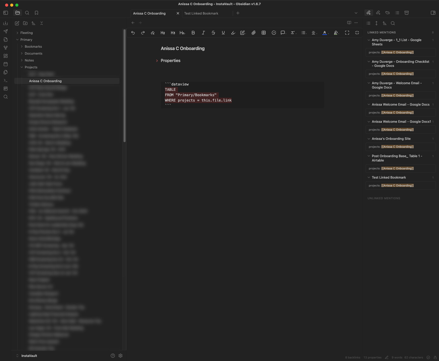

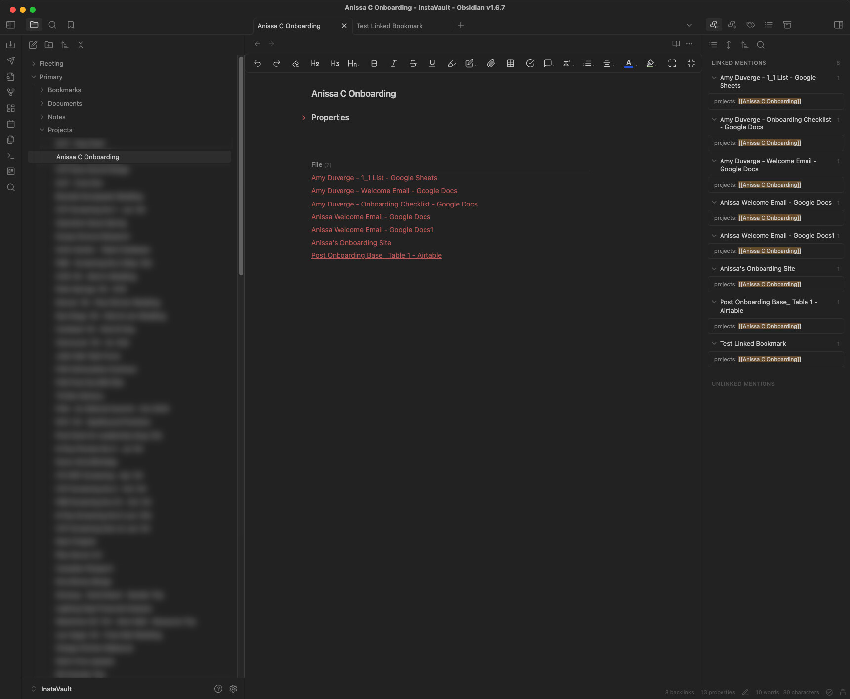

@Pch Sorry to bother again. One hiccup I’m having is that this query seems to only work for existing links between notes, but not for new ones I create. Can’t explain it. Attached are some picture to show the issue. Basically, I created a “Test Linked Bookmark” note to link to another note via a “project” custom field. For some reason, it never appears.
Thanks a ton in advance.

But seeing on the screenshots that the projects key is indeed a list, maybe you could try this :blush: :
```dataview
TABLE
FROM "Primary/Bookmarks"
WHERE contains(projects, this.file.link)
You are truly a genius. Thank you so much!
