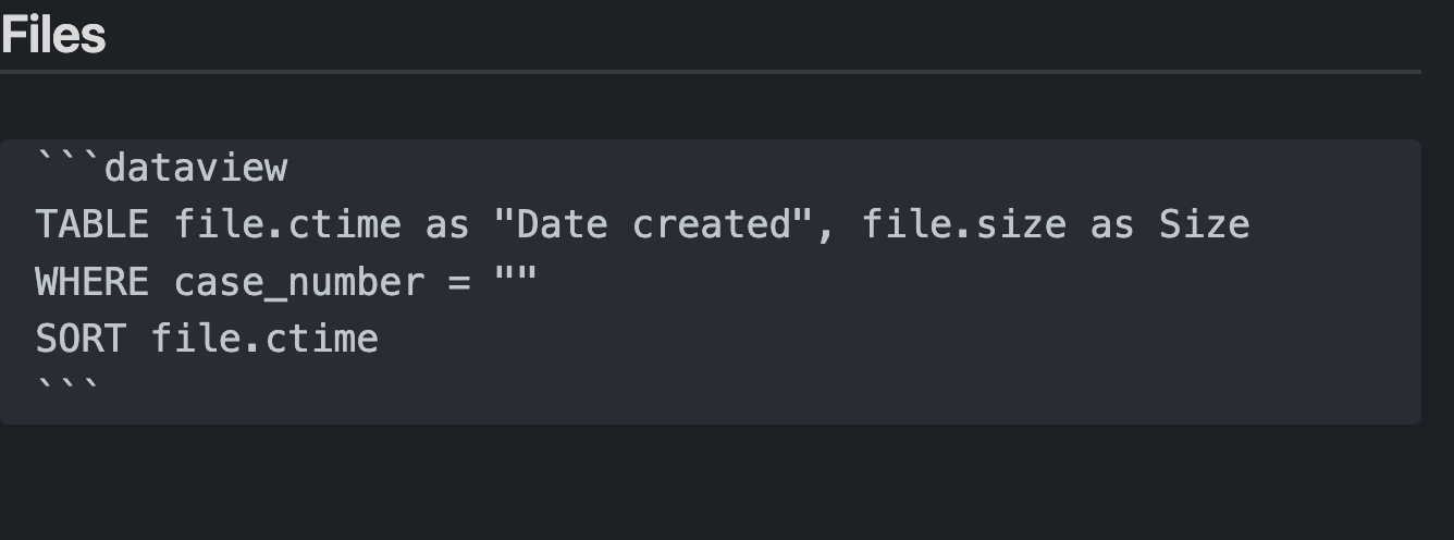

I use Obsidian as my central note taking application for work. Each client has a “hub” page and I link all other notes about that client from that hub.
I do this manually normally, so I’ll be in the client’s hub page and then create meeting notes, for example.
But just in case I miss any of them, as the bottom of the hub page I have a dataview table that catches all notes relating to that client. It does this by filtering based on their unique client reference number, which I store within properties of each note.
At the moment, I am manually adding in that dataview query every time I create a new hub. My hub template is generated by the Templates plugin. It includes the dataview query on the hub page but at the moment I am manually typing in the unique reference number.
Is there any way I can automate the process of the unique reference number appearing in the dataview formula?
It should be possible, but please show examples of how you define that custom number in your hub pages and/or the notes linking to that client. Could either of the notes also link to multiple clients? If so, how does that look?
I put the unique reference number (called a case_number hearing, due to the system that generates the number) between the quotation marks in the penultimate line.
The customer number is truly unique and is two letters, followed by two numbers, then a further letter and 5 five numbers. For example: BT23A56049. The number seems random, but I inherit that from another source. It can’t possibly link to two different clients. I never need to link the note to two different clients.
