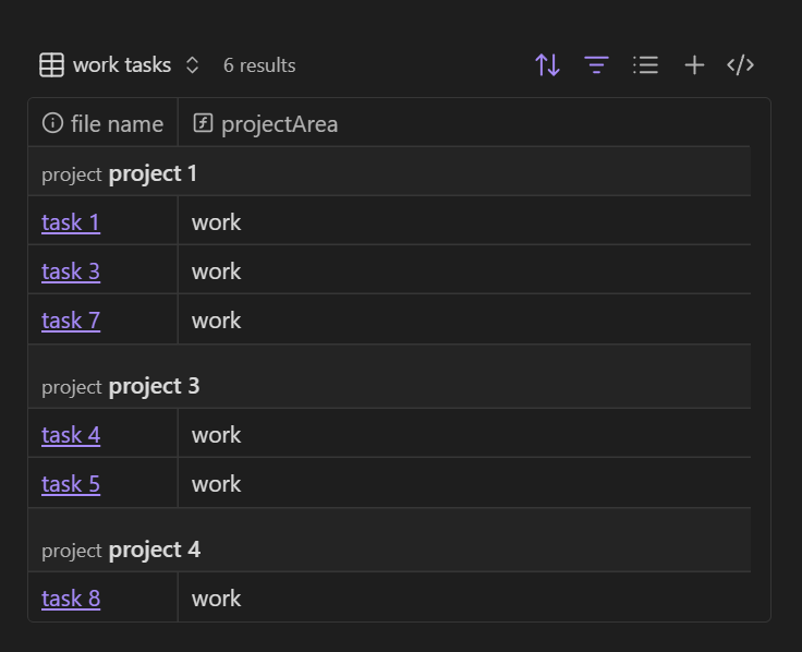

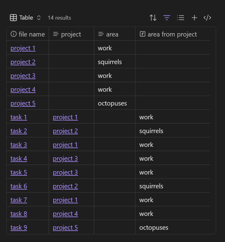

Note structure understood. So say you have these notes:
If your goal is to see the “work” tasks grouped by project, like so:
then give this base a try:
```base
formulas:
  projectArea: project.asFile().properties.area
views:
  - type: table
    filters:
      and:
        - formula.projectArea == "work"
    groupBy:
      property: project
      direction: ASC
    order:
      - file.name
Or are you aiming for something else?
edit: Shortened the same formula as in my last comment, before more people see it and think all the extraness had any real purpose
Thanks. I’m trying to get tasks grouped by project as your show but …only projects with a specific area value.
Oh maybe thats what you’re got here…let me give it a try!

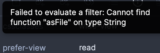

Ok gave it a try and it seems to be kind of working? So it looks like it’s technically doing what I want but for some reason it isn’t showing all of the projects. So there are 15 projects with the area “work” it will show 4 of them. I’m not sure why. I’ve triple checked their front matter.
It does give me this error:
“Failed to evaluate a filter: Cannot find function “asFile” on type String.”
Maybe related?
It means some of your project values are not links to existing files. The filter presumes each project is a single link to a project note that exists.
We can adjust for different requirements; just say what they are.
But presuming you’re good with the above, then look at the missing tasks in source mode to make sure project is formatted as:
project: "[[project 1]]"
Your options:
  • If your project values are different from what’s above (e.g., no quotation marks, not a link, is a list), fix those. And if the project file doesn’t exist, create it.
  • If you prefer to keep some of them as text or uncreated files, then try this filter instead:
    file(project).properties.area
    It’s a “cheap” workaround and less robust than the first option. It requires certain strict things from your project values otherwise they’ll fail the filter. But it should stop the error messages.
    I recommend the first option over this one.
And if you have trouble standardizing your values for option one, feel free to post an example of YAML from those notes to get more eyes on it.

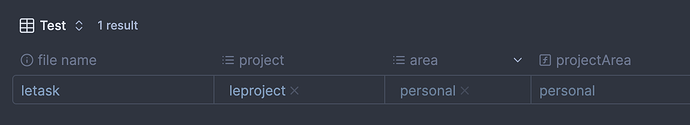

Assuming now that all of your project entries are lists, you can use the first (and possibly only) value by using this formula for projectArea:
project[0].asFile().properties.area
But if you have mixed types—where some are lists and some are text—and you don’t want to homogenize them, then do:
list(project)[0].asFile().properties.area
edit: nipped the same formula again; this is getting embarrassing

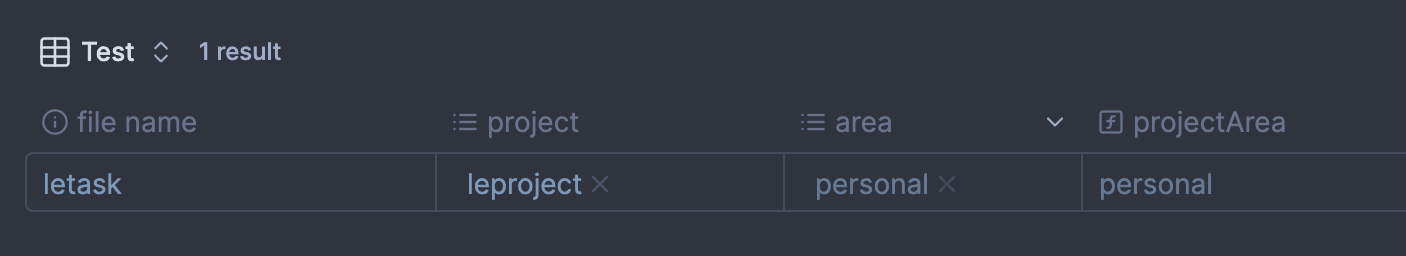

Amazing - work! Thanks so much for all of your help. Though - I still get the errors popping up. Not sure I understood why.
Glad it’s working (for the most part)!
With errors still popping up, though, the base is probably skipping some files. It might return the correct results anyway and from now on, or it might sneak up on you later under different circumstances to give you incomplete results.
Happy to help you figure it out if you want to. Or to let it go if you’re satisfied with it as is.
If you do want to troubleshoot the error, try this for projectArea:
file(list(project)[0]).properties.area
If that stops the errors, then some tasks probably still have projects that aren’t links, or that are links to uncreated notes. If so, then you can correct those links or carry on without worries.
But if errors persist, then what error are you getting now, and can you paste your full base in a code block?

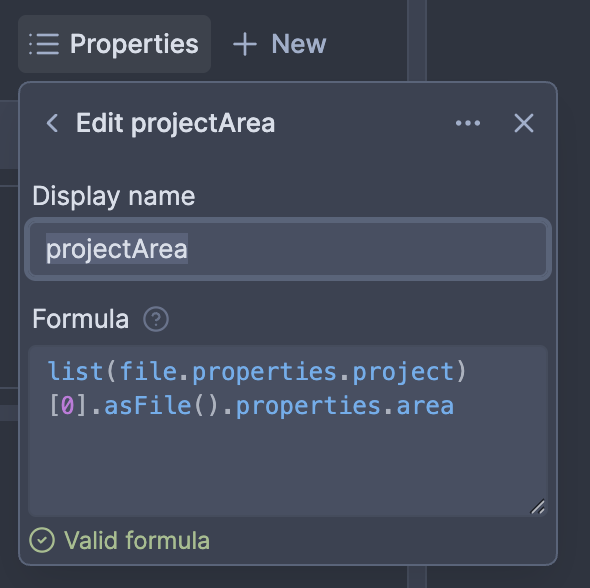

Ok here is what I’ve got:
This is the file that has the base with the filter:
cssclasses:
wide-view
prefer-view: read
formulas:
  projectArea: list(file.properties.project)[0].asFile().properties.area
views:
  - type: tasknotesKanban
    filters:
      and:
        - formula.projectArea == "personal"
    groupBy:
      property: status
      direction: ASC
    order:
      - status
      - priority
    swimLane: note.project
    columnOrder: '{"note.status":["none","on-deck","executing","open","waiting","done"]}'
    columnWidth: 200
    hideEmptyColumns: true
  - type: tasknotesTaskList
    filters:
      and:
        - type == "task"
        - status != "done"
    subGroup: note.project
And the property formula for the base:
Here is the project file (which is titled “project”:
type: project
area: personal
And here is the task file:
status: open
priority: normal
scheduled: 2025-11-27
project:
  - "[[personal]]"
dateCreated: 2025-11-27T19:08:11.053-05:00
dateModified: 2025-11-27T19:08:11.053-05:00
tags:
  - task
type: task
The error pops up whenever I access the base file:
Hope it helps to figure it out! Thanks so much.

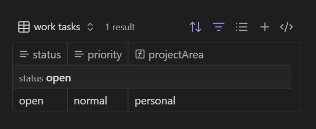

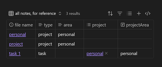

You shared YAML from a note titled “project”. But your task note’s project is a note titled “personal”.
Can you clarify? Or did you accidentally link to the wrong note? (That could be the source of the error.)
However, if “personal.md” has the same YAML as what you showed for “project.md”, then I wouldn’t expect an error.
Your “work tasks” view but as a table, without the view created by Task Notes:
The three notes, for reference:
Erratum: Your screenshot of projectArea made me realize I had been pasting my test version of the formula and not the one I meant to share. Apologies. I updated it throughout the comments. You can use either; they’re the same, just the original one is uglier.
