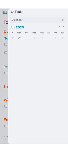

I have been experiencing a slowdown in app response times. The app opens and renders the last opened note in about 3-5 seconds, but after that, any click or action doesn’t do anything. Doesn’t switch notes either. Everything just freezes for a few more seconds.
The best way to know if it can be interacted with is to check if the calendar has rendered completely or not.

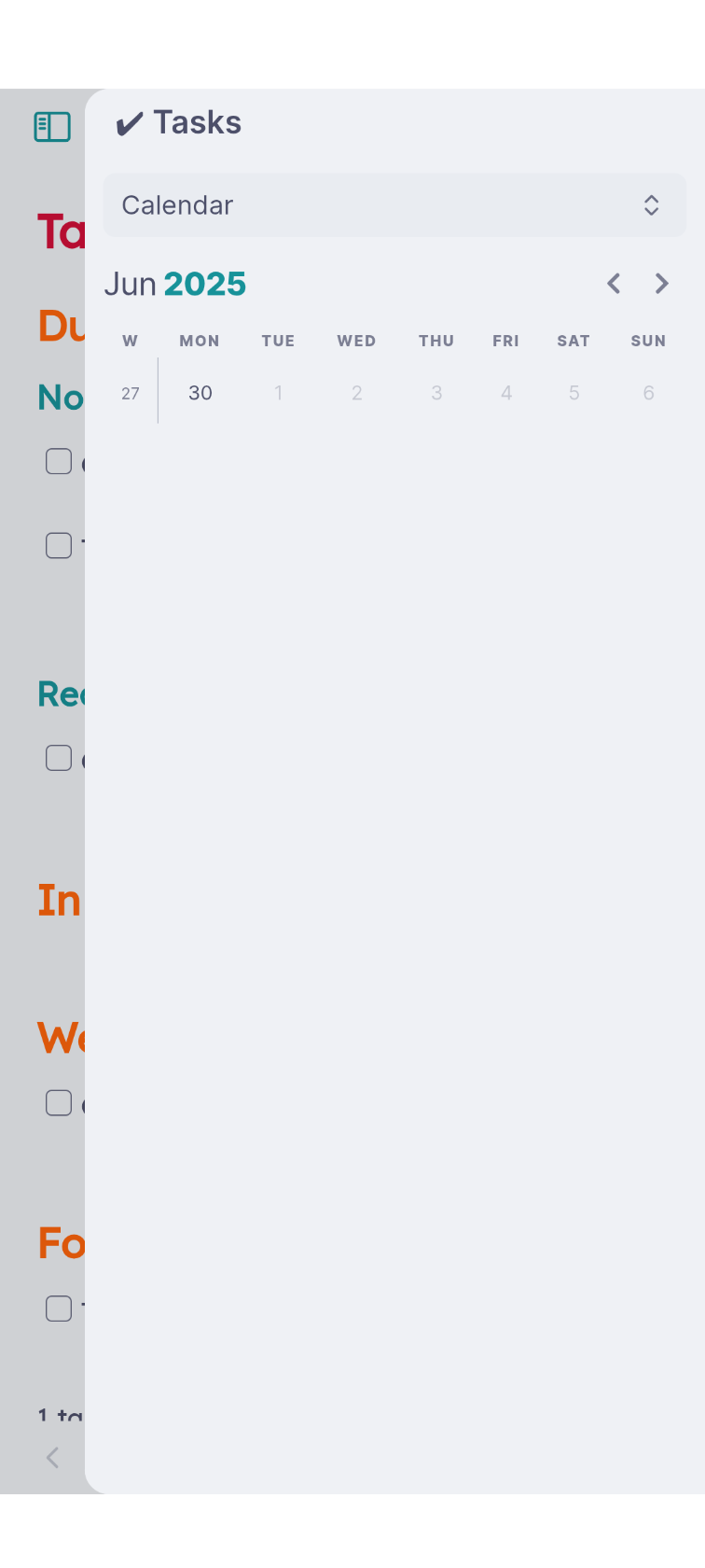

This is how my calendar is frozen and not loaded fully until after a few seconds.
This does happen on desktop too, so I suspect some plugin is holding up something, but not sure.
Any pointers appreciated.
On Android, this is normal: it is time needed for initialization. Developers continue to work on reducing this startup time even more.
You could try turning a single plugin off and restart the app to see if it makes a difference, then turn it back on to test another plugin, and so on.
