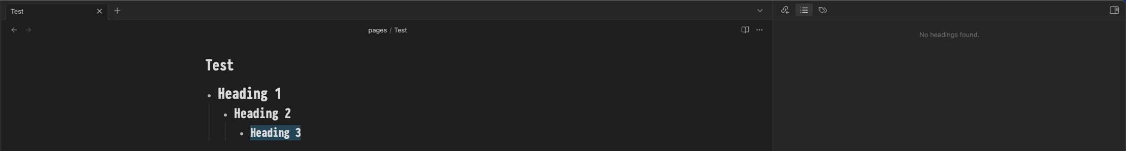

I’m moving my notes from Logseq to Obsidian and the Outline view does not show the headings:
Basic Markdown to reproduce the issue:
- # Heading 1
	- ## Heading 2
		- ### Heading 3
I understand that the - prepending the headings are most certainly the culprit here because if I remove them, the Outline shows.

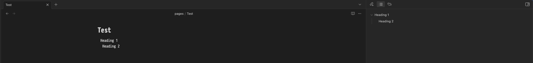

This with spaces before will also work, albeit with a broken formatting:
 # Heading 1
  ## Heading 2

I think if Obsidian added headings that are inside list items to the outline, it would break the outline. For example if you put a list under a third level heading, and one of the list items contains a second-level heading, you would have a confused hierarchy. So I wouldn’t expect the outline to support that.
Looks like this is a quirk of Live Preview. If you switch to Reading View (which is generally a more accurate rendering) the problem disappears.

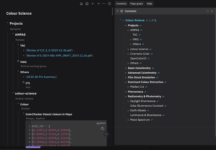

I don’t really see that as an issue, especially when this is an edge case that can be addressed by the user directly. Practical occurrences where someone nests a 1st or 2nd level heading under a 3rd one are probably not that common and should not prevent implementing support for a TOC when outlining.
Logseq has a TOC and it is invaluable when navigating large documents:

Logseq is an outliner, so all of its headings are in lists. It’s a different way of structuring and interpreting things. In Obsidian (and Markdown/HTML in general) if you put a heading in a list item, it’s not clear what that even means.
