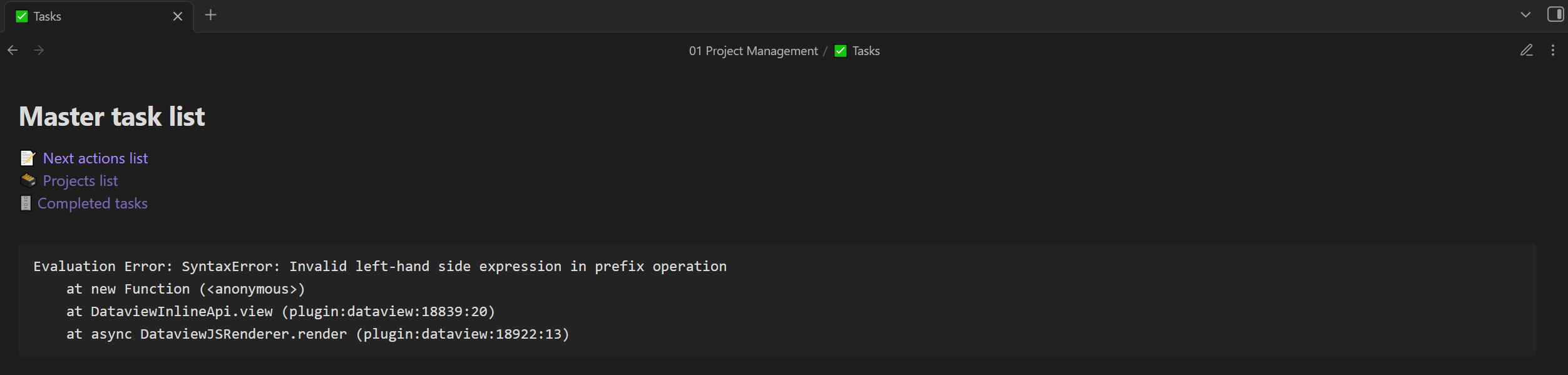

Hi! I also really like your system and started using it on my computer a couple days ago. Now I would like to use it also on my phone. When syncing it, it shows the following error
at new Function ()
at DataviewInlineApi.view (plugin:dataview:18839:20)
at async DataviewJSRenderer.render (plugin:dataview:18922:13)
Does anyone have an idea what went wrong?
You might not have JavaScript queries enabled on your phone in Dataview’s settings page.

I have an issue though, with the Master task list. I keep getting this error:

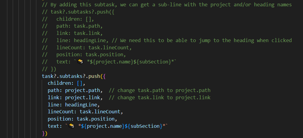

I noticed a bug where clicking on a task on the master task list it would take me to a new empty note. This happened to tasks in projects named a specific way. Like “1 Boots” or “1-Boots”.
I tried to fix the bug with claude sonnet and it was fixed when I replaced
task?.subtasks?.push({
children: ,
path: task.path,
link: task.link,
line: headingLine, // We need this to be able to jump to the heading when clicked
lineCount: task.lineCount,
position: task.position,
text: `🗃️ *${project.name}${subSection}*`
with
children: ,
path: project.path, // change task.path to project.path
link: project.link, // change task.link to project.link
line: headingLine,
