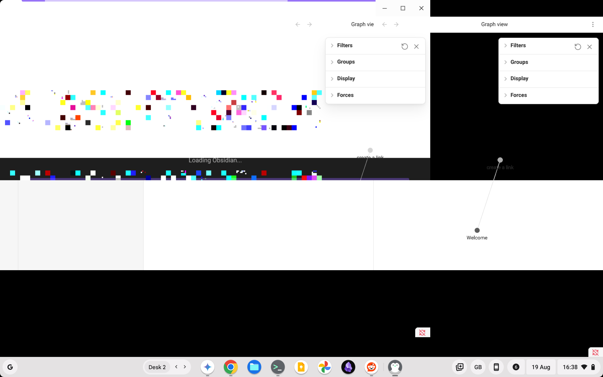

Graphical Corruption/Rendering Failure on ChromeOS Linux (ARM64)
  1. Launch the Linux Development Environment on a ChromeOS device with an ARM64 processor.
  2. Download and run the official AppImage for ARM64. The same issue is also reproducible with the Flatpak and .deb versions.
Y
The Obsidian application should render its user interface correctly.
The application window appears corrupted, with a white screen and graphical artefacts. The issue occurs immediately upon launch, before a vault can be created or opened.
[Please use the “Show debug info” command in the app if possible, otherwise state that it’s not possible due to the rendering issue.]
I have attached a screenshot of the issue. When launched from the terminal, the application outputs a number of GPU-related errors. The key error messages are as follows:
[...]:ERROR:gpu/command_buffer/service/context_group.cc:177] ContextResult::kFatalFailure: ES3 is blocklisted/disabled/unsupported by driver.
[...]:ERROR:gpu/command_buffer/service/gl_utils.cc:439] [...] GL_INVALID_ENUM: glGetIntegerv: Invalid pname.
The rendering issue is slightly improved at a lower screen resolution, but the application is still unusable.

I don’t think we can help you with this.
If you can, perhaps thy to run obsidian without GPU acceleration. Settings>Appearance>Advanced
Otherwise, use the android version.

I am perfectly happy with android version but some Chromebooks don’t support Play Store and AppImage is a recommended option. Will test your solution and will let you know if it helped.
You’re a star! This solved a problem, but I did a slightly different approach… I ran the appimage with --disable-gpu:
igor@penguin:~$ ./Obsidian-1.9.10-arm64.AppImage --disable-gpu

And there it is:
On my Fedora 42 I installed it with Flatpak and it works well. Somehow the side-loaded Debian 12 doesn’t quite like the official appimage and flatpaks. Still, I think I will stick to Android version on ChromeOS because it’s a lot faster, the fonts are rendered properly and overall it is more native to chromeos than sandboxing.
P.S. yes, you can add the --enable-unsafe-swiftshader to remove the annoying error message and the output is now cleaner:
$ ./Obsidian-1.9.10-arm64.AppImage --disable-gpu --enable-unsafe-swiftshader
