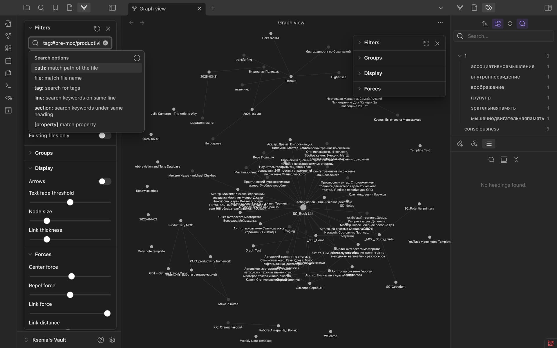

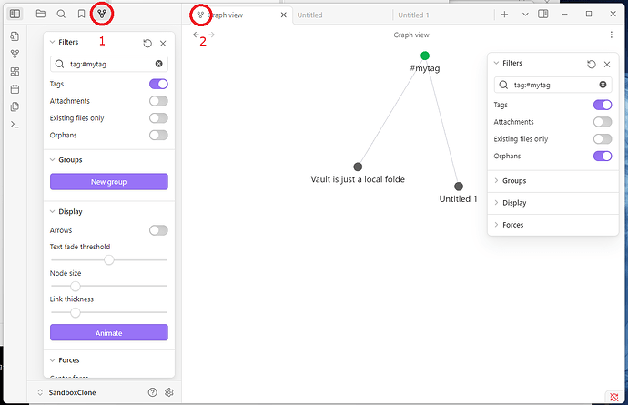

  • Tag filtering does work in normal file search panel (see screenshot #1), but does not work at all in Graph View (screenshot #2)
  • Graph UI seems completely disconnected from the controls

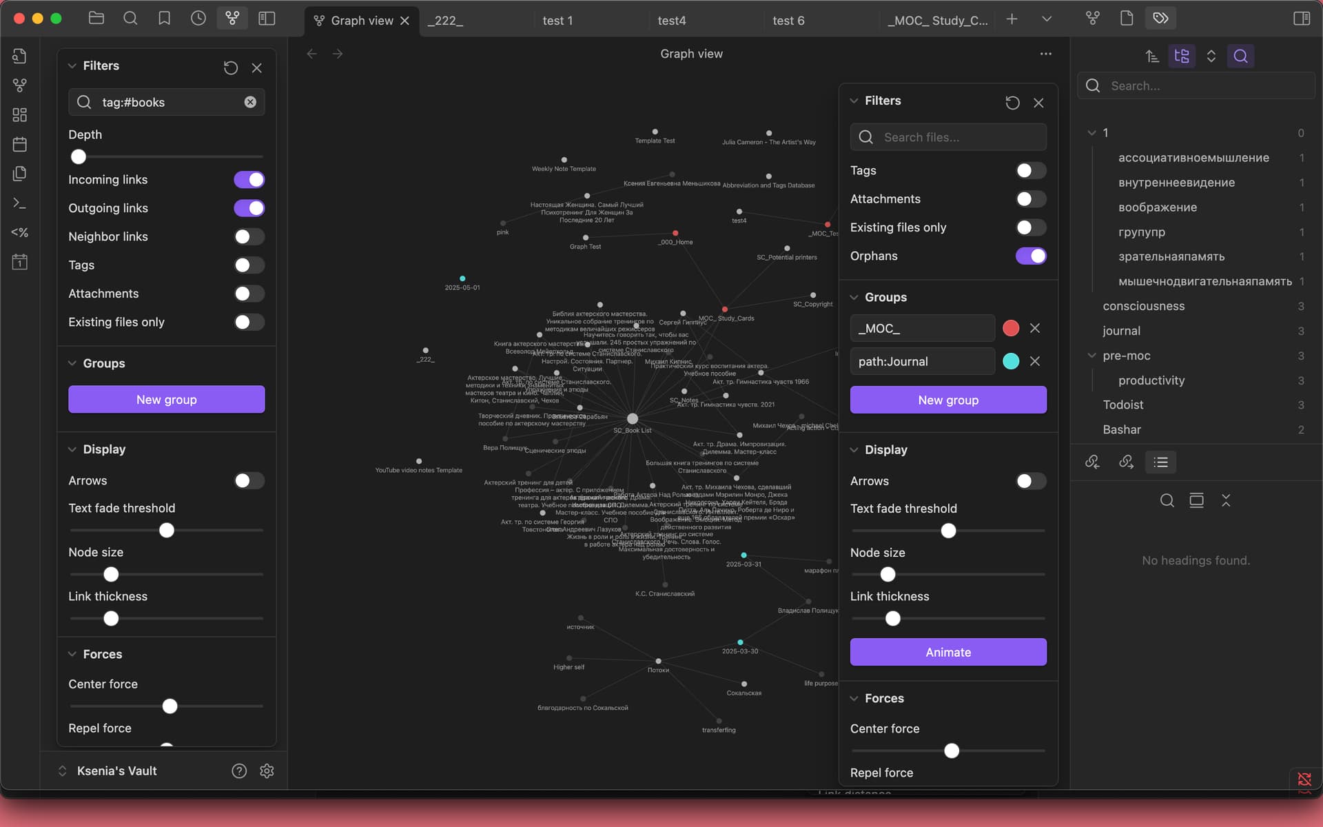

I attach screenshots again. So basically in my main vault I have two filter tabs. The one on the left doesn’t work. Im my test vault I only have one tab and it does work. I am not sure why my main vault has two.
It appears you have two Graph views open: one in the sidebar and one in the main window. They are separate.
If you collapse Filters, Groups, etc., for the one in the sidebar, you should be able to see the Graph under the Graph settings.
Obsidian_KEqVHC33PG
You can right-click and close that tab if you don’t want it in the sidebar.
Thank you, that helps I closed it and now there’s only one Filter tab. However, out of curiosity, I still don’t understand why this tab wasn’t working. I collapsed it like you showed in the video, but it didn’t reveal a graph, just an empty space. Also under “filters” it has “Incoming links” and “Outgoing links” (see previous screenshot) which the graph on the right doesn’t have. Anyway, thank you for your help!
The one with “Incoming links” and “Outgoing links” listed is the Local Graph view and it’s linked to a note that is currently open/focused. I missed that looking at the screenshots.
That what it was! Thank you, I understand now!
