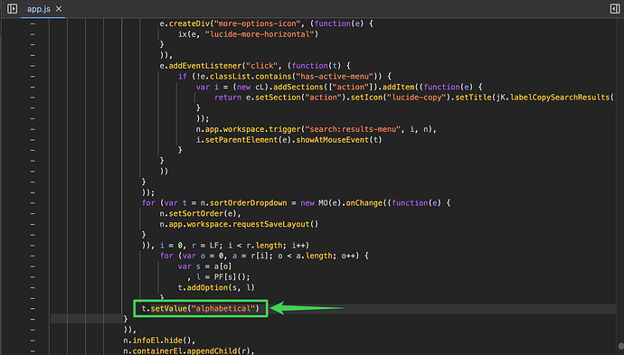

  • There appears to be a different code path inside Obsidian for clicking the toolbar icon to open the Search pane vs. using the Hotkey. I have observed that, after a fresh launch of Obsidian, clicking the icon does not clear the previously entered query, while using the hotkey does. This may be important.
  • I have found a reliable way to repro the issue (in restricted mode, no plugins):
    1. Activate the Search panel
    2. Execute a query
    3. Set sort order to Modified time (new to old)
    4. Navigate away from the search results (e.g. back to the File Explorer)
    5. Quit Obsidian
    6. Relaunch Obsidian
    7. Use the hotkey to trigger the Search function
    8. Observe that the sort order has reverted to alphabetical
  • I found this bit of code in app.js which I assume is directly or indirectly responsible for changing the value of the dropdown.
