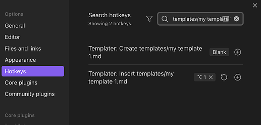

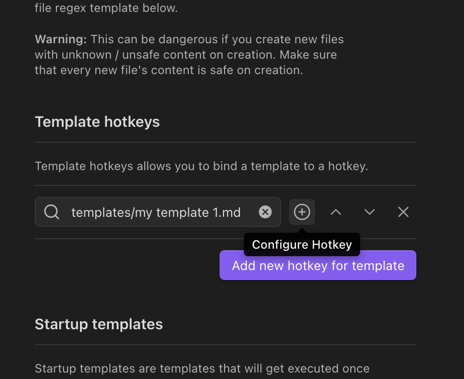

b. Instead of step 6, I can copy / paste the templater script on the alias field and execute right there
So far I have only used templater when creating a new file but it seems you can use templater to execute a script on an existing note and modify carefully certain fields
