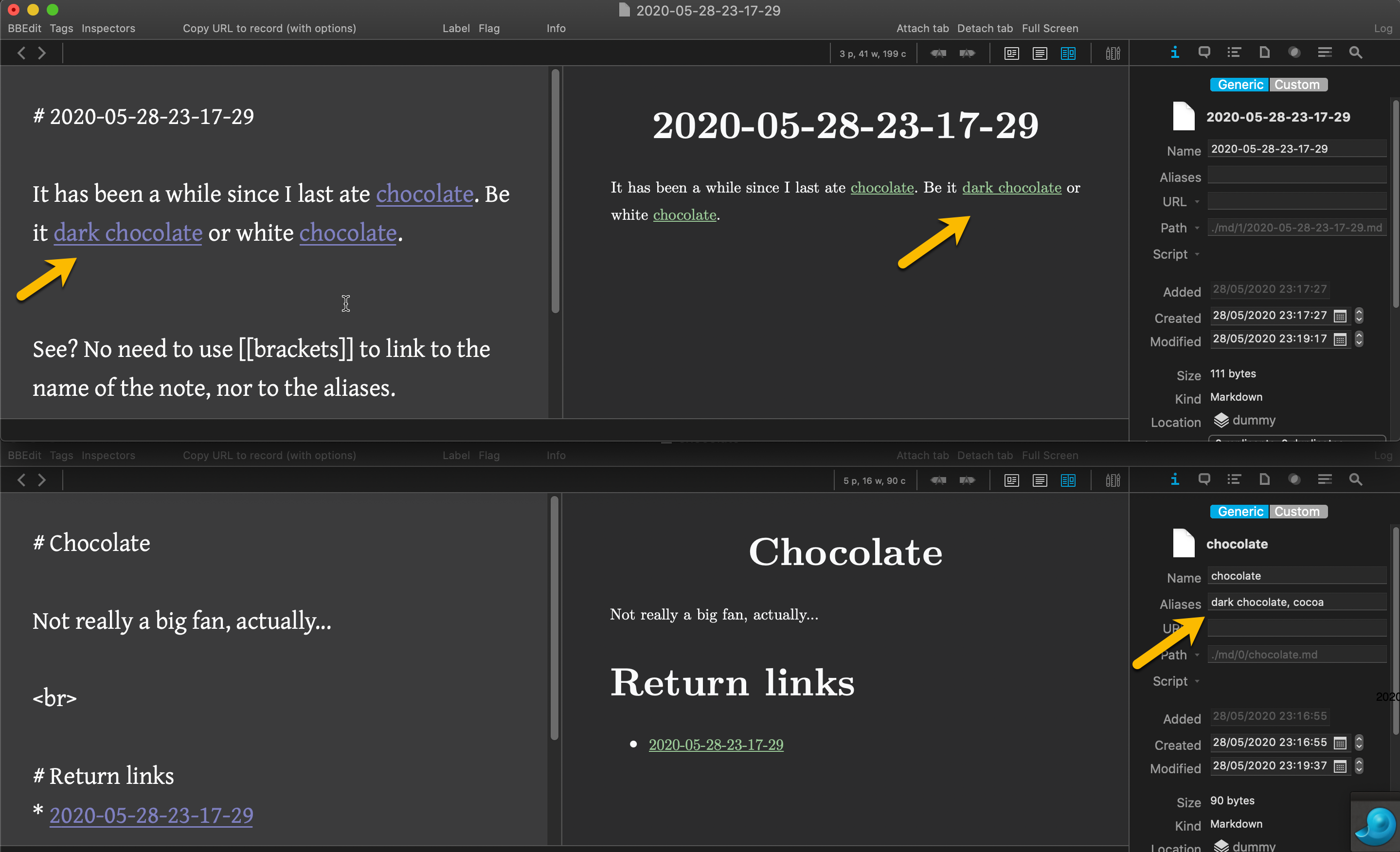

My suggestion would be for an option to turn on automatic wiki links. This means that…
chocolate would appear as a link without the need of adding double brackets. I can just click on it as it is. And precisely the same thing would happen with the aliases of chocolate (cocoa, milk, dark chocolate). Should I happen to type dark chocolate, then voilà, we would have a link.
@bernardo_v
I am not familiar at all with the behaviour you are describing. Perhaps you could point out which software behaves in this way.
The Unilinks or Uni-Alias (can’t remember the exact name) in TiddlyWiki, as I mentioned to @lizardmenfromspace.
My suggestion would be for an option to turn on automatic wiki links. This means that if I have a note called “chocolate” and the in another note type “I like chocolate” then a link would automatically be added to “chocolate” even without me adding [[.
