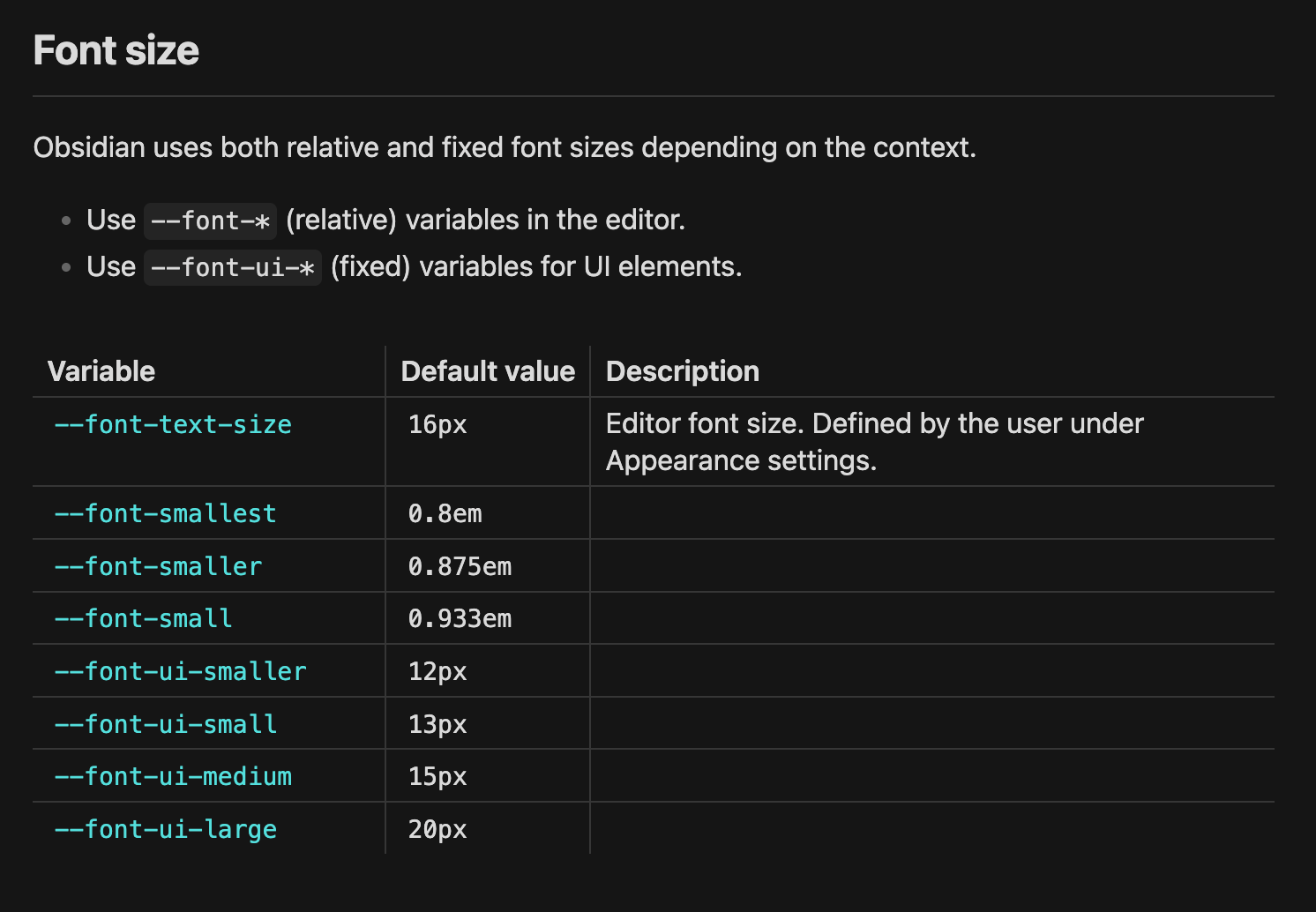

CSS variables are documented in https://docs.obsidian.md/Reference/CSS+variables/CSS+variables
In typography section you will find --font-text-size:
https://docs.obsidian.md/Reference/CSS+variables/Foundations/Typography
Hello! Thank you for your reply. Unfortunately none of these do what I’m looking for. This is an example from my browser, without font-size-adjust:

I’m not talking about variables, I’m talking about CSS properties supported. I guess it’s just not supported?
