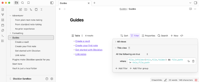

For reference, Bases does have a list view.
I have an embedded base in all my folder notes showing all the files in the folder (and some properties). It’s been working out.
Here’s what the list layout view looks like:
The filter:
file.inFolder(this.file.folder) && file.path != this.file.path

Yes, List, I had forgotten that I could change the Base display type to List.
I also realized that the Folder Notes plugin allows the auto creation of a Base when a new folder is created. So I am doing that now. This avoids the Editing Mode versus Reading Mode issue as the base is natively rendered as links, so no a code block that has to be rendered.
I created a .base template and set up Folder Notes to use that as the template. Works great.
