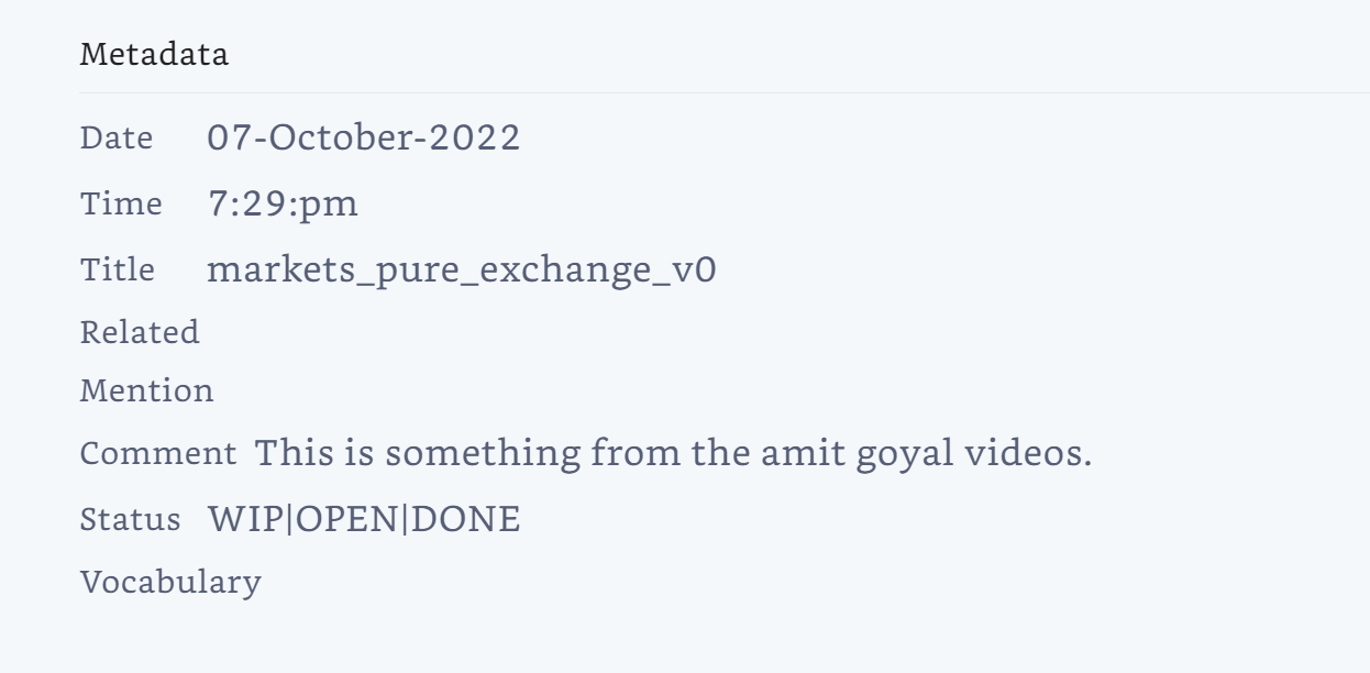

Since the new update, am facing some issues regarding metadata management. In the new update , the metadata is automatically folded in the read mode, thus most of the metadata is not visible unless it’s changed into edit mode. This is a terrible UX problem, as in most of the cases when you have long metadata there are several mistakes in the metadata which are often corrected while reading the notes, or some extra points are added while working on the notes.
Since the scope of the data view is endless, data view is used in several use cases, as you can see in the screenshot I have a data point for keypoints, this enables me to see the keypoints without even making a dataview index . So it would be a great help if you could remove that feature or provide a provision to disable the automatic folding of metadata, this feature is making the note cleaner but from UX perspective its a terrible experience, people who write long meta data will suffer , and will have to read the notes in edit mode itself . Plese do look into this .

It seems like the Metadata header leaves out all the multivalue and empty fields, even though they show up in the fields list of dv.span(dv.current()). They are not even folded away, they’re completely missing from DOM.
In addition there is something funky in how the reference and multielement differ in the dataview list view. Where the latter has a list at a lower level when compared with the reference (and the multivalue).
