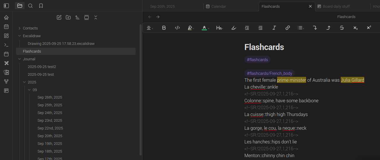

Hello,
surprisingly the 1st question on making a flashcard with a cloze, but the note’s text shows the highlight due to the double equals at the start and end of the cloze text. The Review flashcards running doesn’t show any of the text, only the flashcards in the question::answer format.
Specs:
Desktop Raspberry Pi 5 desktop OS → Obsidian App Current version: v1.9.12 (Installer version: v1.4.16) → Spaced Repetition Version: 1.13.3.
I tried:
  • backspacing in front of the double equals starters, which removed the highlight, however Review flashcards still doesn’t show any of the cloze text, just flashcard questions::answers.
  • I read the guide, discussions, Obsidian forum search: flashcard cloze and an Internet quality search: Obsidian flashcard cloze.

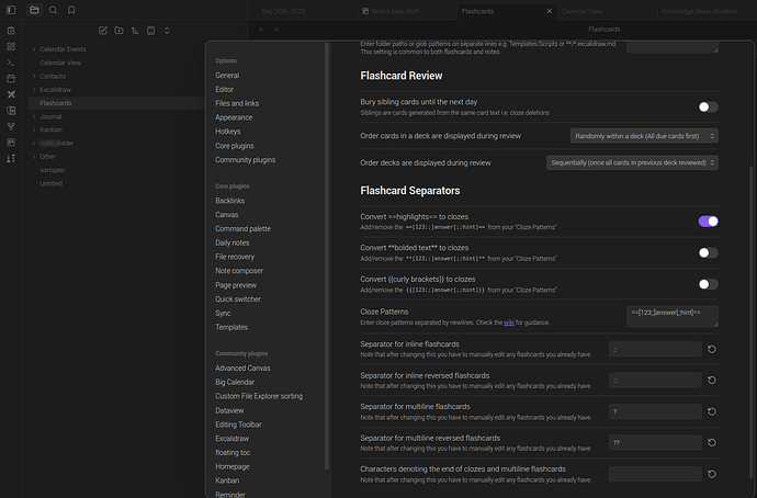

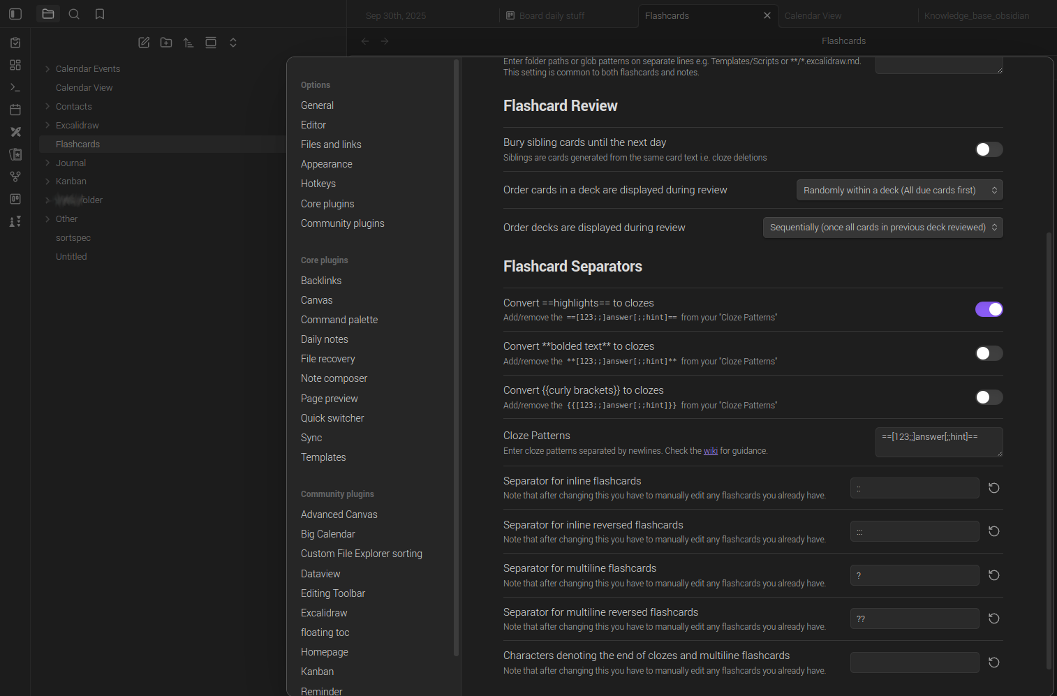

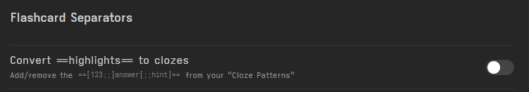

Based on the screenshot I assume you are using the Spaced Repetition plugin.
Since this is a plugin specific matter it’s a good idea to check if there’s any documentation offered by the plugin. (It does; Cloze Cards - Obsidian Spaced Repetition)
That said, can you check and see if the following setting is toggled on in the plugin’s settings?
Thanks. As per 1st post Specs (specifications), Spaced Repetition Version: 1.13.3 and guide also read.
Rechecked Plugin’s Flashcard Separators and is already enabled.
I disabled and re-enabled, however same challenge.

Based on the 1st post the cloze doesn’t show up at all, right? Or does it show up wrong?
If it’s the latter can you post a screen shot of it too?

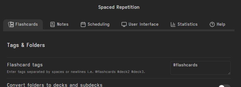

Can you check if the test file has the same tag as the one shown here?
i.e. see if it’s ‘flashcard’ instead of ‘flashcards’, etc.
And of course, check if the tag applied to the note is the same as well.
Thanks for the suggestions.
Yes, the plugin, original and test note all have #flashcards, plural rather than singular.

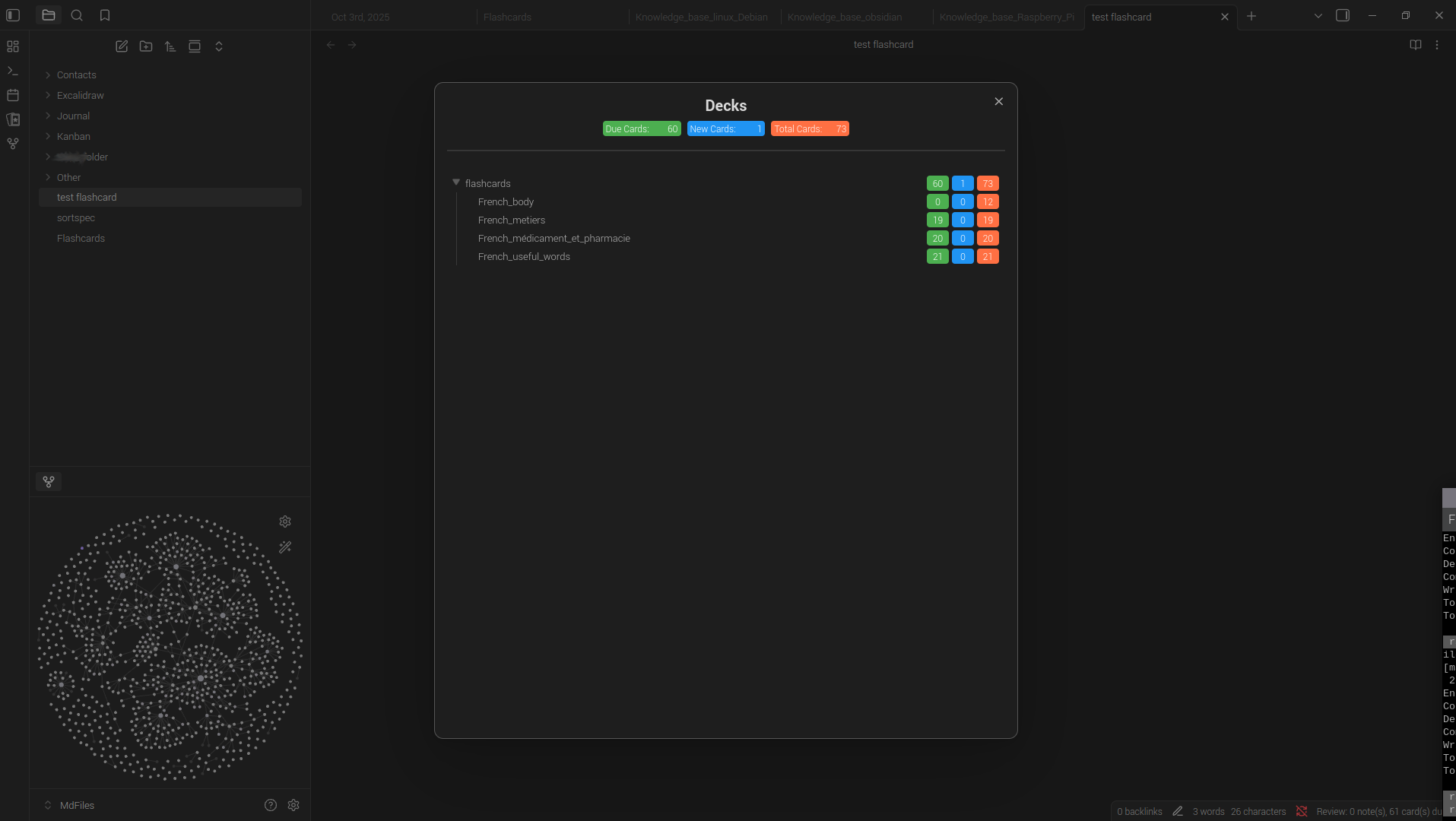

  1. Reinstalled plugin Spaced Repetition Version: 1.13.3.
  2. Deleted the Flashcards note, created a new Test note and cloze appears in Review flashcards.
  3. Re-added the faulty Flashcards note text to a new note named Flashcards1, ran Review flashcards, and the deck #flashcards/French_body doesn’t show the cloze.
  4. Added the working cloze text from Test note to the Flashcards1 note and deck #flashcards/French_body and the cloze in line 6 fails to show in the Review flashcards (the clozes in lines 2 and 3 do however present and function).
