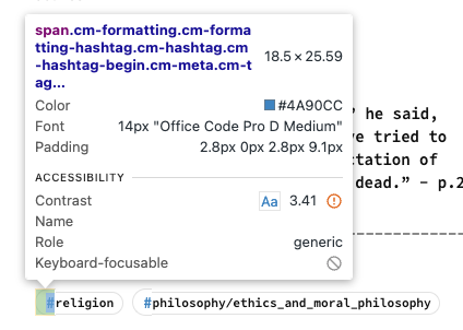

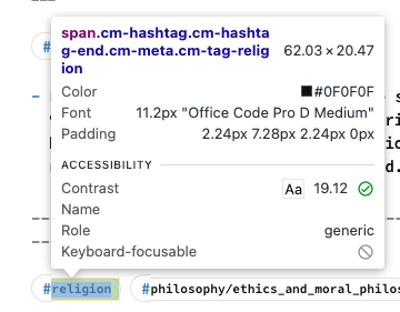

See the attached screenshots. The border around the hashtag doesn’t match the border around the tag itself. Is there a way to fix this issue?
Searched the forums, messed with the CSS, but had no luck.
Your currently have different font sizes and padding heights between the two. Does making those equal align your borders?
