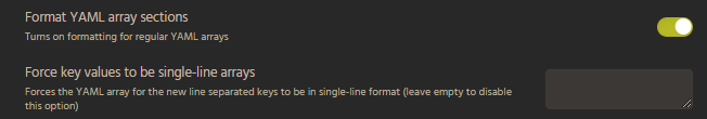

I’ve tried the plugin Linter to fix in bulk the formatting for all the values of that property. Is there this option: “Format YAML array sections” (here you can see the details in the plugin documentation), but it formats all the values instead just the one I want (“tabSelection” in this case). Is there a field in the plugin that says “Force key values to be single-line arrays” and I’m putting just the name of the property I want to change but it changes them all (so I’m not using it correctly I assume).
And it formats it like this with the value between brackets instead of fixing it the correct way like the one shown above

I’m looking at the Linter plugin menu and I’m not seeing the option to lint the notes and make the Properties I want as “single-line” formatted as text. I can see that those options are just for “alias” and “tags”.
Basically, I have to format all the notes being lists type to being text type (i.e the format that those notes are using in the YAML make the disticntion). If that option do exists in Linter, I still didn’t find it. Do you know how can it be done?
should be this one (never tried it yet):
you type in tabSelection and lint the vault (make a backup beforehand if you want)
i’m not sure the emoji can be a problem (i’m not making use of emojis since i started using the supercharged links plugin, which is prolly not use for you here)…?
good luck
Thanks. As I mentioned above about trying the process you say with Linter, the issue is this:
It formats the property, but as an array (i.e still a list), not as text (which is a different type. Text type properties are not an array, so are not formatted as such).
So the result I’m getting when I try Linter with this option is this:
and this still is an array

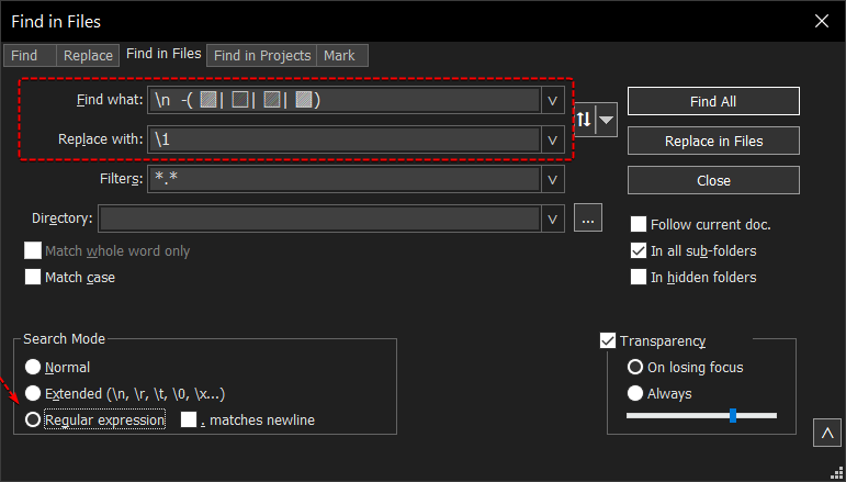

The solution I’ve found was to open the Obsidian folders as text using an external (I used Notepad++). I didn’t know sh1t about regular expressions and these kind of external editors but I realized that could be useful to know it for the use case to do bulk changes in the vault :grin:.
Turns out that “regular expressions” are a way to search for common text string in the vault and be able to replace them, using these external text editors (it’s worth clarifying).
So after some research the way I’ve found to change all the values of one particular property was this one:
I open Notepad++ > File > Open Folder as Workspace > select Obsidian folder
Then you to find the values to change: Right click in Obsidian folder > Find in Files > Enable “Regular expression” in Search Mode
This is he formula for my particular use case
In “Find What” I put: \n -( 🟧| 🟨| 🟩| 🟥)
what this does is to search all the values that have have the format of a new line with a “-” and any of those color emojis. The pipe ir like an “or”, so it will search - :orange_square:, or - :yellow_square:, etc
In “Replace with” I put: \1
what this does is to change the value found before for just the emoji, so it will replace the new line, and the “-”, for just the emoji (what I wanted to do)
This is how it looked
I tested it before running it into the whole vault, and seemed to work spectacular. So I ran it, and it fixed all the notes as I was intending to do, and life is amazing.
