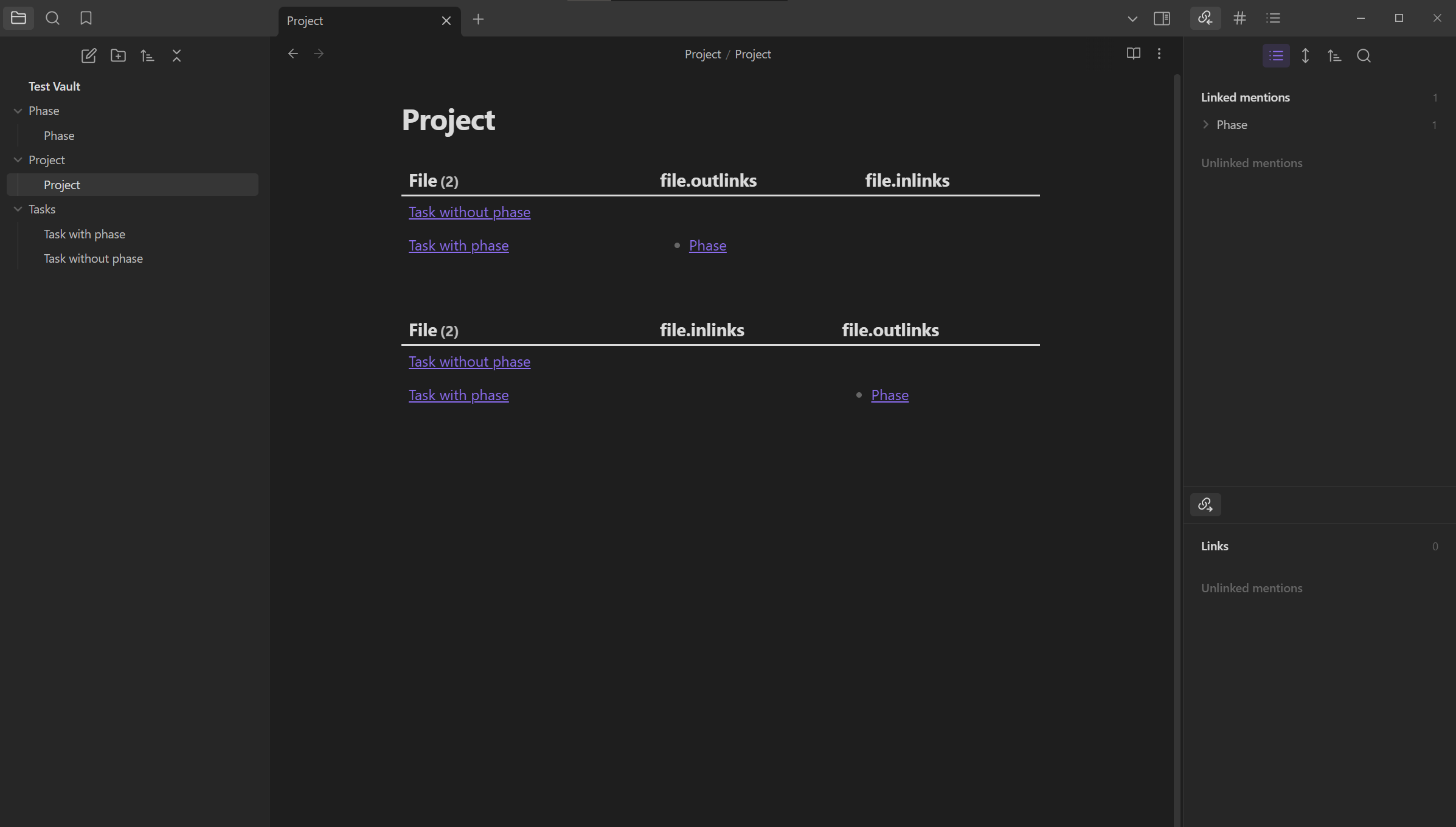

Filter files based on outlinks matching to current file inlinks not acting like expected
Im trying to only returns the files that have matching outlinks to the inlink of the file the query is in. Instead im getting all the files regardless of out-/inlinks that are in the specified path.
Bottom query contains the following:
TABLE file.inlinks, file.outlinks
FROM "Tasks"
WHERE contains(file.oulinks, this.file.inlinks)
Im expecting to get only “Task with phase” from the query but instead I get every file inside of the Tasks folder.
Concept
Im trying to have a query inside of a project that shows tasks that belong to phases linked to that project.

Hmm maybe I am not understanding this correctly, but in my eyes it doesn’t look like I’m duplicating anything.
Tasks don’t link to the Project, the file that the query is in.
Tasks links to phases and phases point to projects.
Task → Phase
Phase → Project
file.inlinks for Project will be Phases while Task file.outlinks will point to Phases.
Your solution does work but it means I’ll have to add the phases to the query everytime a phase is added to a project, which is something im trying to avoid.
A solution I’ve been avoiding is to link or tag every tasks directly to the project itself but that feels clumsy.
