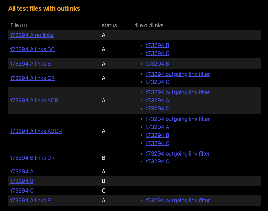

My test file setup
First of all, let me describe my test file setup based upon your hints with a simple table query:
All files follow the name of the status early in the name, and which other files it links to, with “R” being a non-interesting outlink just to show that filtering do work.

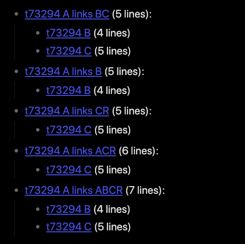

Finally, a variant reading the file content
The last query variant uses the DQL query to get the same result as before, but in the result.successful branch we read the file contents of the various files and appends the number of lines of each file. (And we do this slightly ineffective as we re-read the files in the outlinks sections. This could be avoided by keeping track of which files we’ve already read, but I’m leaving that as an exercise for the reader :slight_smile: )
```dataviewjs
const result = await dv.query(`
  LIST statusMatches
  WHERE status = "A"
  FLATTEN list(filter(
    file.outlinks,
    (f) => contains( list("B", "C"), f.status ))) as statusMatches
  WHERE length(statusMatches) > 0
function linesInFile(content) {
  return content.split("\n").length
if ( result.successful ) {
  const values = await Promise.all(
    result.value.values.map( async (aFile) => {
      const content = await dv.io.load(aFile.key.path)
      aFile.key += ` (${ linesInFile(content) } lines)`
      aFile.value = await Promise.all(
        aFile.value.map( async (outlink) => {
          const content = await dv.io.load(outlink.path)
          return outlink += ` (${ linesInFile(content) } lines)`
      return aFile
  dv.list(values)
} else
  dv.paragraph("~~~~\n" + result.error + "\n~~~~")
Maybe this is a whimsical example, but you never said what you wanted to do with the content anyways, so there you go. It should however showcase how to do file reads based upon a result of links. The output of this variant is:
In summary, it’s no problem to list out files with status matching in both the original or linked files, and if you are so inclined these result can be further processed using dv.io.load() or similar methods. It does get a little hairy depending on which method you chooses, and you need to thread carefully when starting to use multiple await..async stuff in javascript.
