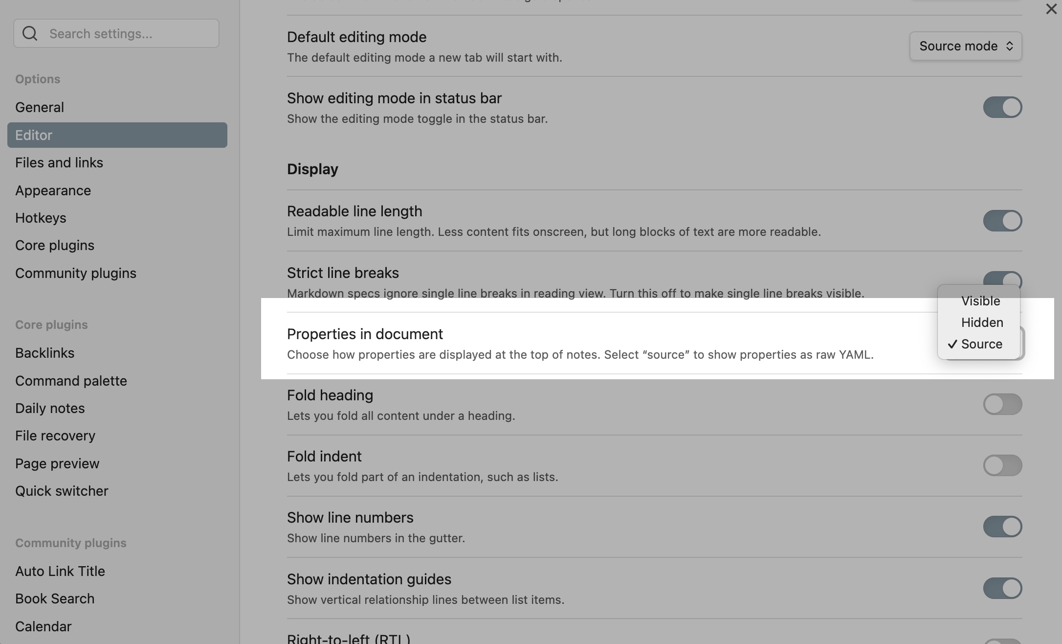

Have you checked the setting shown in the image below?
I thought that affected what gets shown at the top of the pane in “reading” view.
I just tried all three options. It shows or hides a list of tags at the top of the “reading” pane, but it doesn’t affect the availability of the “file properties” pane in the right-side slide-in thing, or add the icon that was there. All I have is the standard set - backlinks, outgoing links, all tags in the vault, outline of the current document, and “All properties”, which looks like a “file box”, and where selecting “tags” selects all documents which have tags in the pane at the far left.
