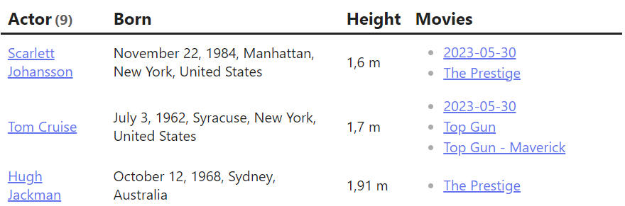

I add to my knowledge base information about the films I have watched and the actors associated with these films. I have a separate file “Actors”, where using the Dataview code a table with data of the actors is displayed: name, date and place of birth, etc. Among this data are the films in which they starred. The idea is that these films will be notes-films that I previously created. I do this using file.inlinks.
However, I ran into a problem: I need to exclude the daily notes folder (Daily) from the mentions output. Now it looks like this:
Here’s the code I’m using to output the data:

I keep all my notes in the root. I also use the “Daily” folder to take daily notes. In my daily notes, I actively link information to the notes from the / (root). So far, the formula that I use is the only working solution for me and where is not yet suitable for solving my problem.

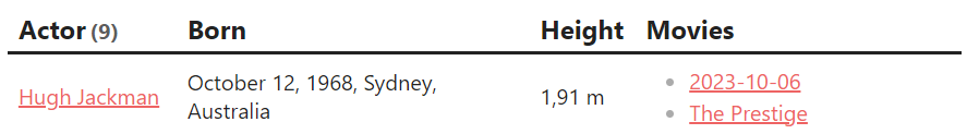

When writing daily notes, I can insert the name of an actor and make it a link to a separate page. Dataview treats this as a mention of the actor, adding a daily note to the list of movies that actor has starred in. Here’s what a daily note looks like:
And here’s how Dataview processes information:
That is, all I need is to exclude daily notes from the results.
