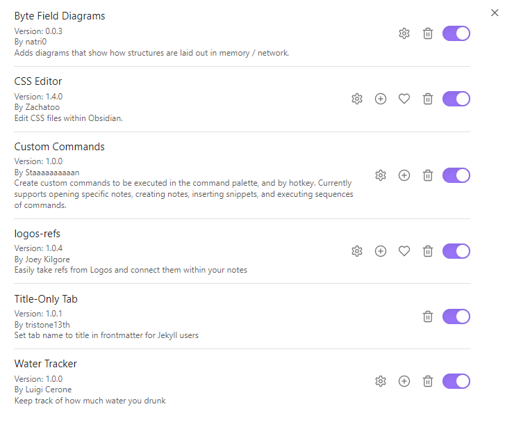

It seems to be random. After i reset my computer, i get error on different plugins. From the recently launched list i get this error on:
  • Custom Commands
  • logos-refs
  • Byte Field Diagrams
  • Title-Only Tab
  • Water Tracker
  • YTSummarizer
  • aDHL
  • Rainbow Folders Fixer
Is basically every 2 or 3, one doesn’t load. Even if i had it installed before, like solo-toolkit for example. I just was capable of seeing, and then after restart the computer, i can’t. I don’t think it has to do with the plugin itself. Also, i tried editing my post, but couldn’t, so sorry for double posting. There’s a lot more than just the list i posted above.

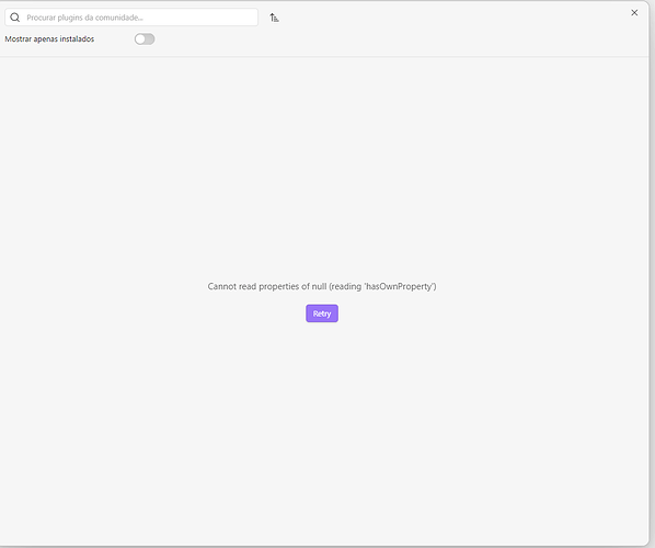

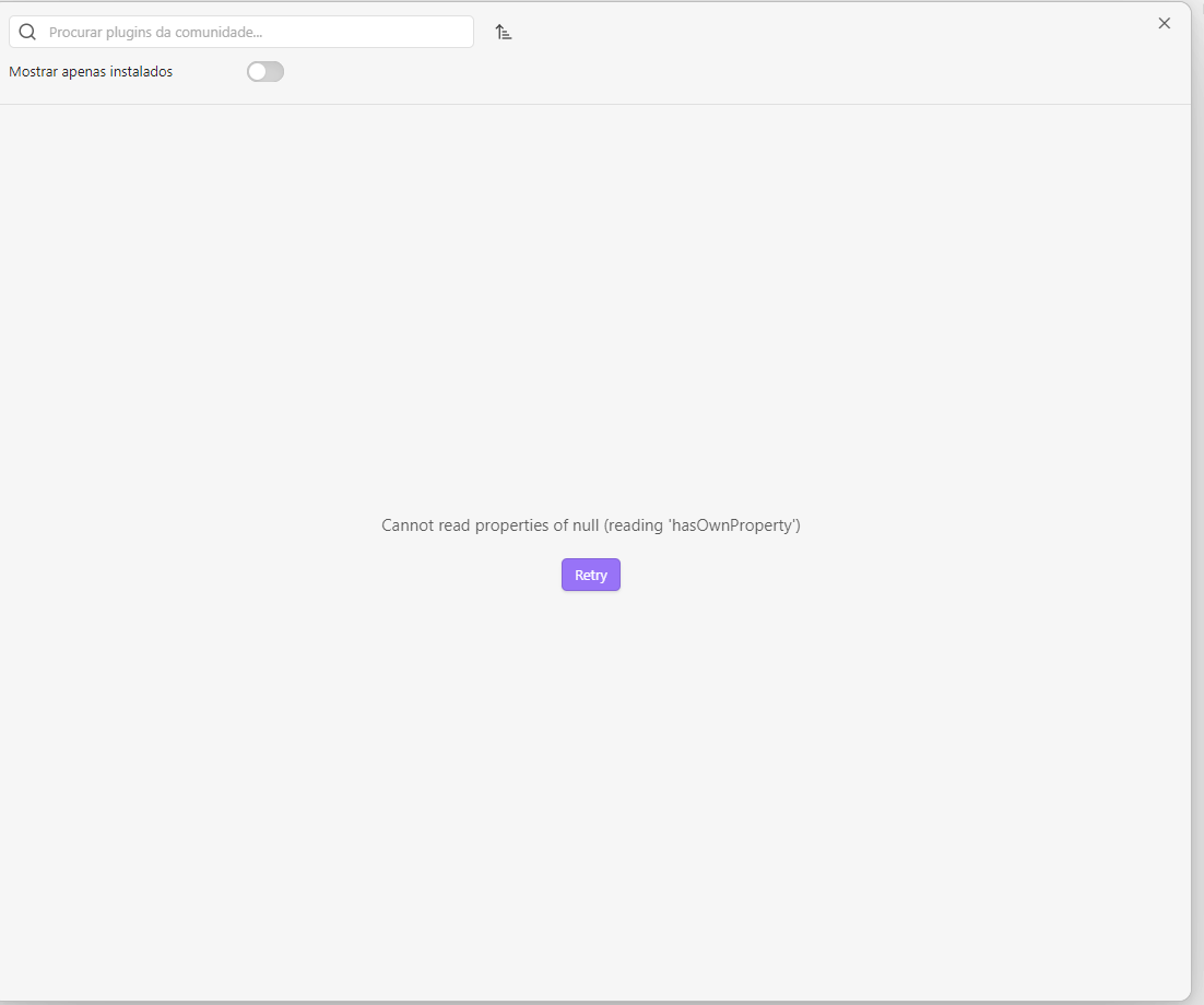

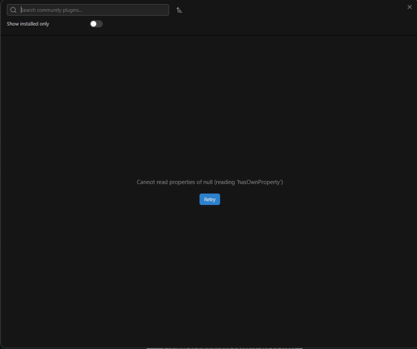

Also, after restarting obsidian i’m getting this error:
So i can’t even open the plugin page at all now. what is happening… never had this kind of errors with obsidian before.

hi, im having the same issue so i hope to add something. I have 2 main vaults, and in the first one in installed Minimal theme Settings. It installed correctly, and then when i went into the community plugins again to install another thing, it showed the same “cannot read properties of null”. I downloaded the new installer, and nothing. I deleted the plugin folder, and that seemed to fix that issue. Now, i cant open the Minimal Theme Settings in my other vault. Tried the same fix that i described (reinstalling, deleting plugins)and nothing, i get the “failed to load plugin manifest”

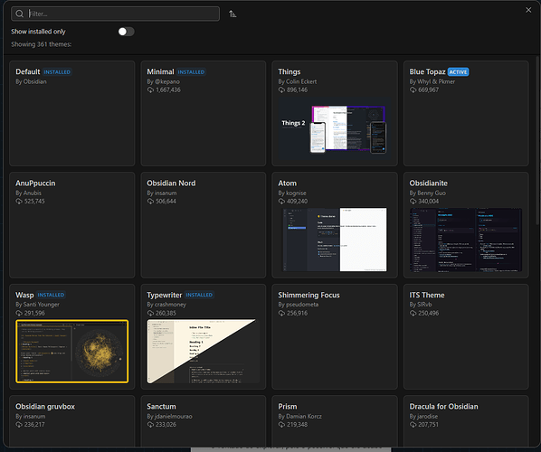

Like you, after a fresh reinstall of Obsidian, it works for a short while, but then the problem comes back and it loses the connection, showing “Failed to load” errors for both community plugins and themes.

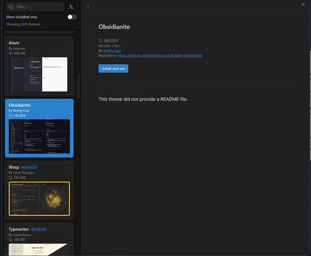

I can also share some of the issues that have been happening:
  • Release notes fail to load inside Obsidian.
  • Unable to update themes/community plugins.

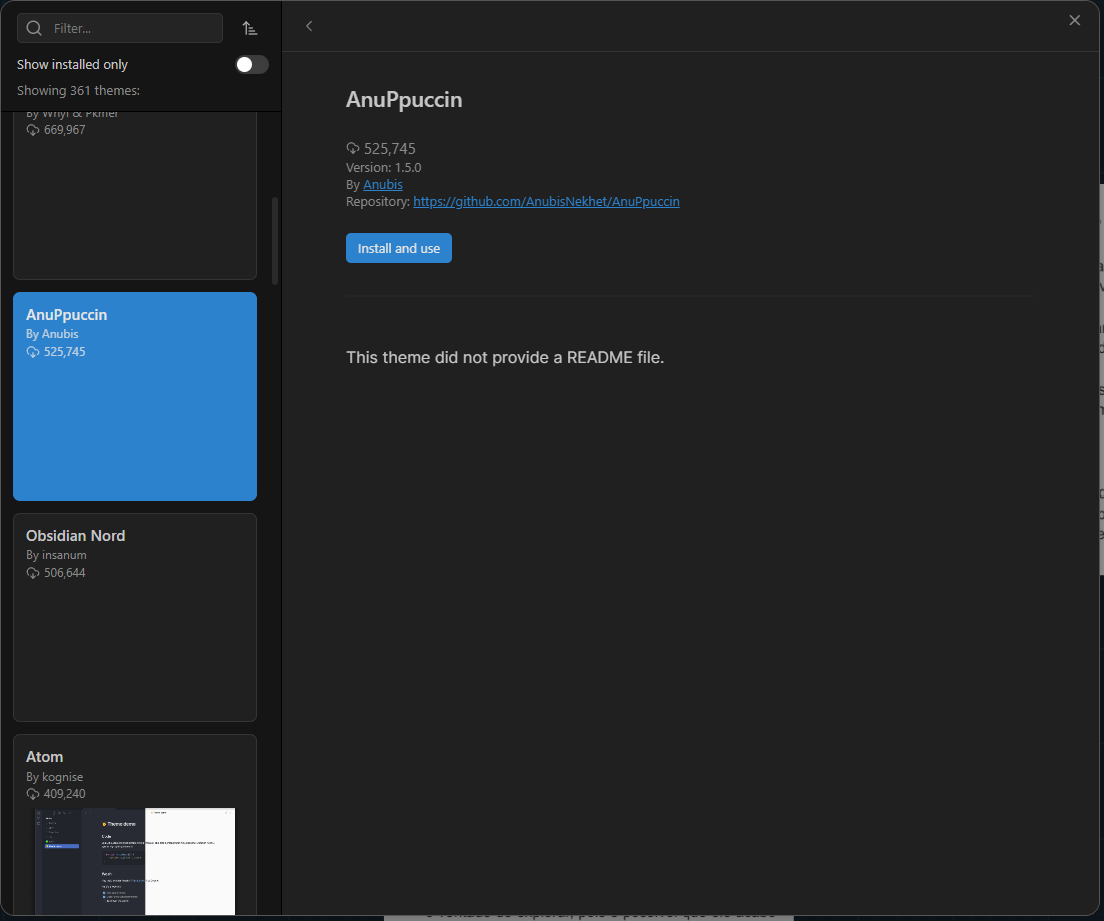

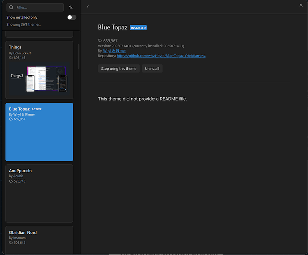

  • When browsing for community plugins, most of them, when clicked, do nothing and just return a “Failed to load plugin manifest.” message to the console.
  • Those who manage to load, can’t display the README file, but at least can be installed.
  • Publish works just fine.
  • Obsidian Sync is also working as intended.
I can confirm this issue started recently, and while I can’t for sure say it is related to the latest update, it seems like so. Would say this started happening in he last 4 days at most.
