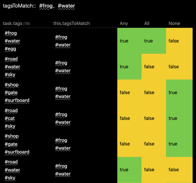

So to get you started on doing such a query here is a query I ran on my test data:
tagsToMatch:: #frog, #water
```dataview
TABLE WITHOUT ID
  task.tags,
  this.tagsToMatch,
  "<span class='" + choice(anyFlag, "cellOK", "cellWARN") + "'>" + anyFlag + "</span>" as Any,
  "<span class='" + choice(allFlag, "cellOK", "cellWARN") + "'>" + allFlag + "</span>" as All,
  "<span class='" + choice(noneFlag, "cellOK", "cellWARN") + "'>" + noneFlag + "</span>" as None
FLATTEN file.tasks as task
FLATTEN any(map(this.tagsToMatch, (m) => contains(task.tags, m))) as anyFlag
FLATTEN all(map(this.tagsToMatch, (m) => contains(task.tags, m))) as allFlag
FLATTEN none(map(this.tagsToMatch, (m) => contains(task.tags, m))) as noneFlag
WHERE file.folder = "ForumStuff/f57/f57484"
WHERE file.tasks AND task.tags
Where top part of the output is as follows:
(This also utilises some extra markup and CSS to color cells to make it easier to spot the various responses). So your result will most likely not look as colorful, and you do need to remove the WHERE file.folder ... line for it produce any results at all for you.
