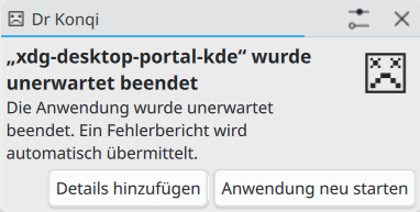

Just after the explorer window crashes for selecting the export path, this window here shows:

Maybe the problem is here
ASSERT failure in PreviewJobPrivate::getOrCreateThumbnail: "Local path for url file:./Desktop is not absolute: ./Desktop", file ./src/gui/previewjob.cpp, line 716
Excerpt from journalctl -xe | grep xdg-desktop-portal-kde just after the crash:
Jun 10 19:57:10 kiwi xdg-desktop-portal-kde[101546]: ASSERT failure in PreviewJobPrivate::getOrCreateThumbnail: "Local path for url file:./Desktop is not absolute: ./Desktop", file ./src/gui/previewjob.cpp, line 716

I can reproduce this problem.
Given that it works in other DE and it works in KDE if you select a location in the left-hand side first, I am inclined to think that this is KDE bug.
I was about to file a BR upstream, but I noticed that one already exists. If any of you did it, thank you!
