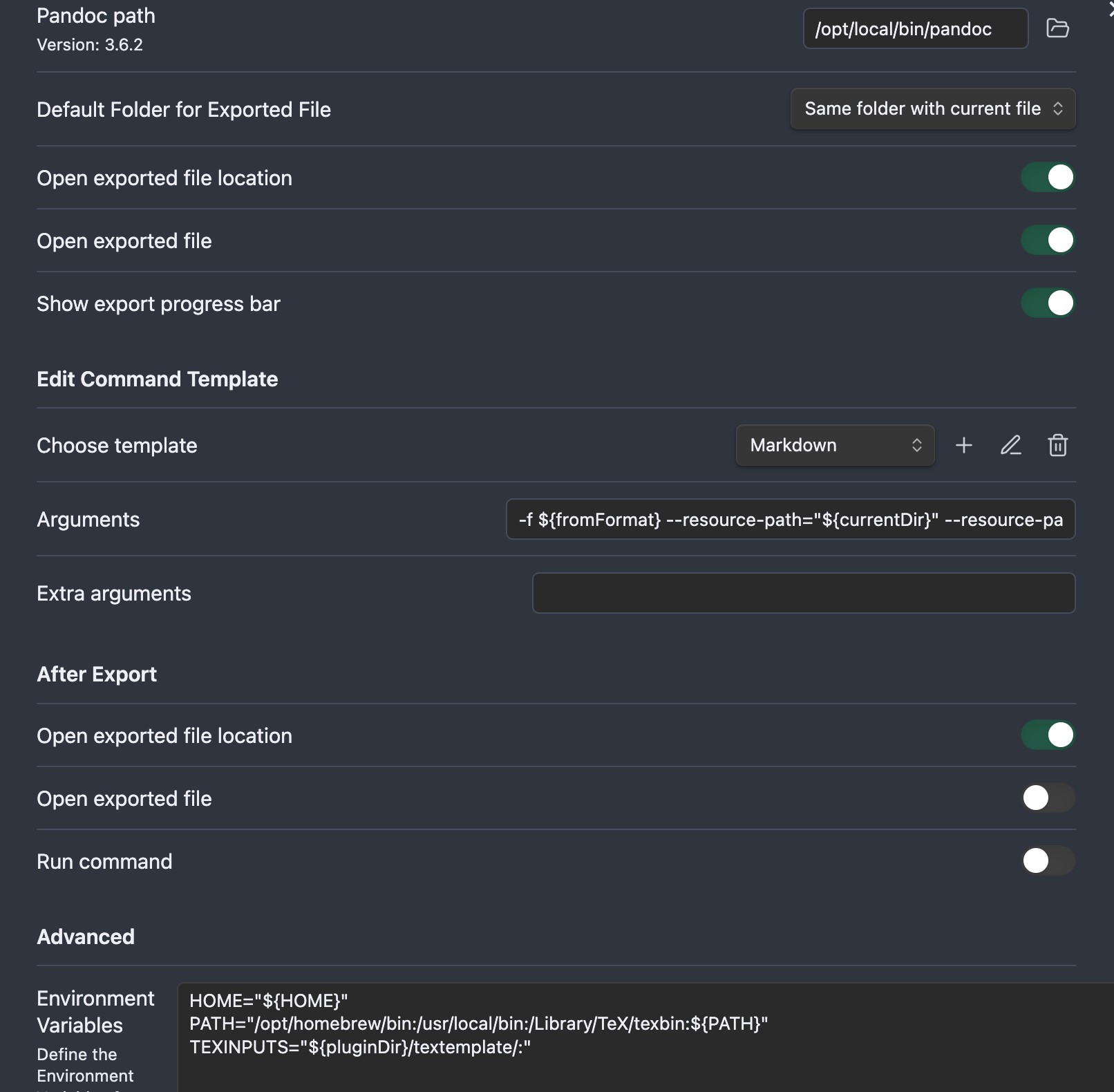

Hi all, I’ve been trying to export my .md file to a PDF, but it seems not to be working. After researching for hours and sorting out all the issues with Pandoc, it still does not seem to be working. Currently, I have both ‘pandoc plugin’ and ‘export setting’ under the community plugin , and when I try to export to PDF, I get this message in the screenshot.
I checked the forum for solutions, tried to set the right PATH for pandoc, but it seems not to be working.
Have you looked into what’s happening at line 70 in your file? It’s complaining about some undefined control sequence at the very end.
So either look at line 70, or search for the “Implementing condifentiality” text, and try playing around with the text in that area to discern why it’s failing.
Possibly also just try to export another similar document, and check that it’s not your general settings which are failing.
Hey holroy, after several hours I realized that Obsidian does not offer Canvas to pdf export, yet. I can only export them as images at the moment.
