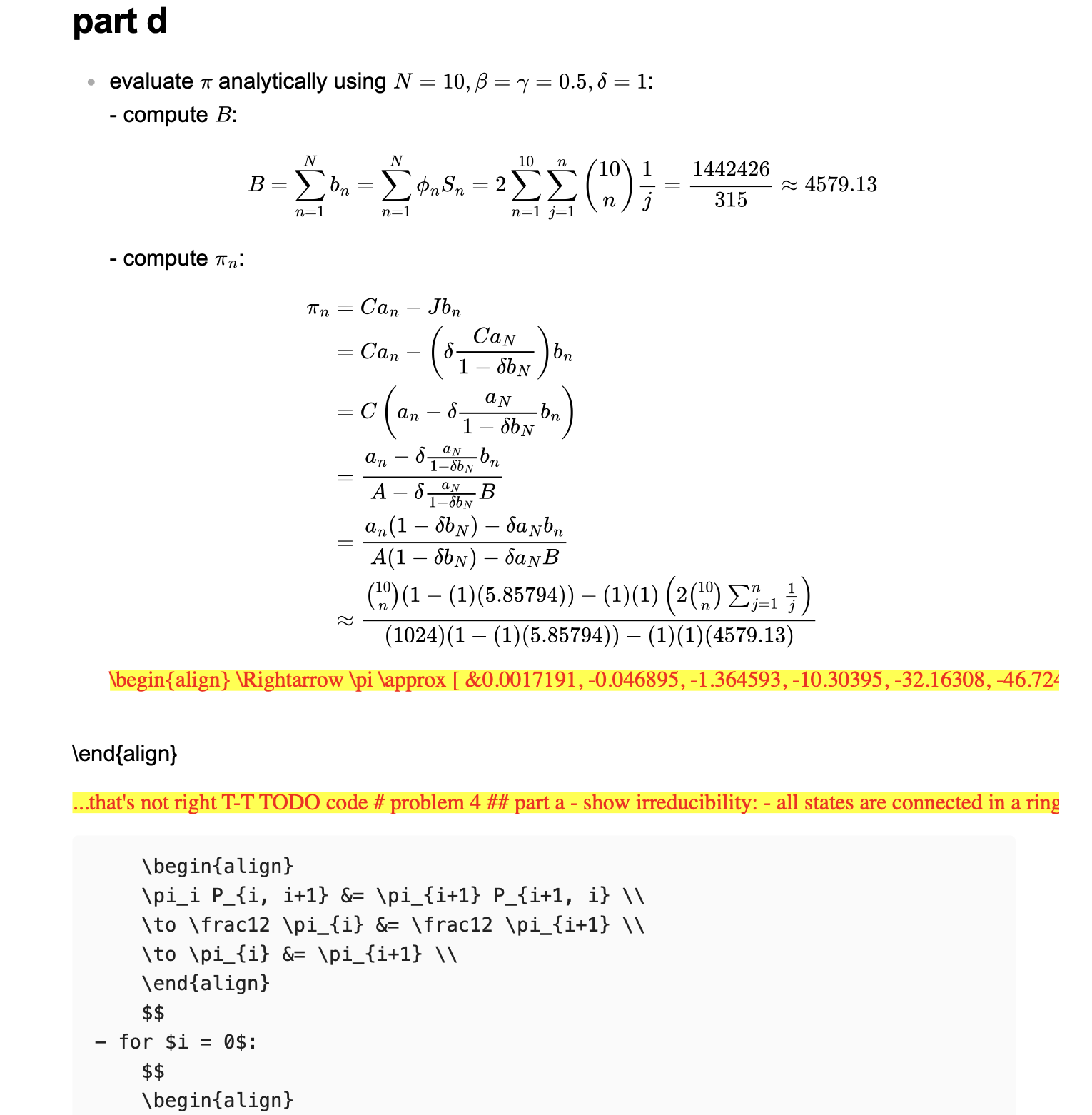

Export pdf misformats bullets & latex
  • enter restricted mode in any vault
  • write the following file:
## part d
- evaluate $\pi$ analytically using $N = 10, \beta = \gamma = 0.5, \delta = 1$:
	- compute $B$:

  • generate a pdf of the above text with the “Export PDF” tool
  • view the pdf
Did you follow the troubleshooting guide? YES
the pdf should render correctly, identically to how it’s rendered in write mode:
  • all bullets should look correct
  • all latex blocks should be correctly rendered.
  • no part of the file is rendered as a literal text code block (since that isn’t used in this file)
  • none of the second-indentation bullets in the first header “part d” aren’t rendered correctly
  • the last latex block in “part d” gives error text
  • everything below the latex error is shown as a literal code text block

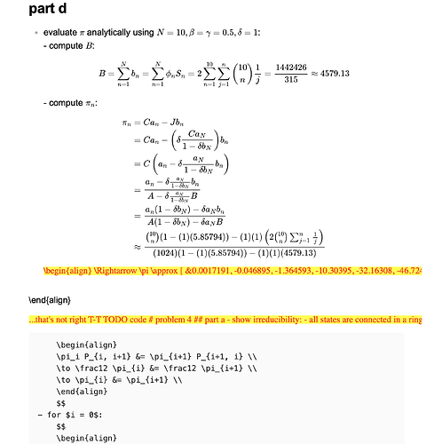

a screenshot of the bug:
  • bug workaround: if you add a newline before the offending latex block (i.e., between lines 30 and 31), the rendering bug goes away
This has nothing to do with print, the same happens in reading view. It’s another (more complex) manifestation of
Also, please note that, according to markdown, you must add blank line at the end of the list to begin a new paragraph. So your workaround is not a workaround, is what you should actually do.
if this is intended behavior, then the bug is in editing view: all three views (reading, editing, pdf export) should be consistent.
I don’t care much for what the rules are exactly, but when I try to export a pdf when in editing view, I expect it to look the same. the difference in behavior is unexpected and (in my case, trying to submit homework before a deadline) detrimental.
In general, I agree you that they should be the same.
However, there are some intrinsic limitations on how live previews works by virtue of being still bases on a plain text editor.
On top of this, here there is a bug in reading view, that I linked.
