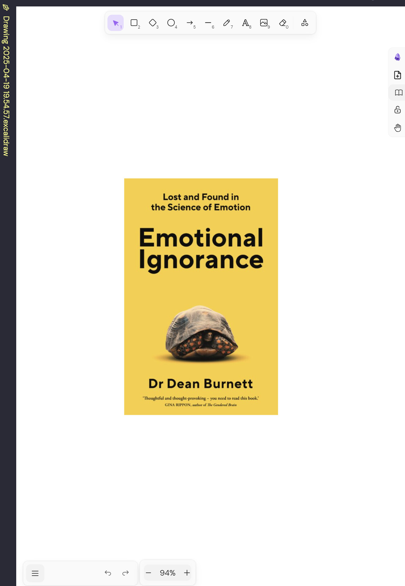

If you use the Excalidraw Plugin in Dark Mode then you’ve more than likely experienced the problem of colours looking washed out.

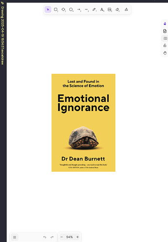

For Example this Book Cover in Light Mode is in it’s original colour

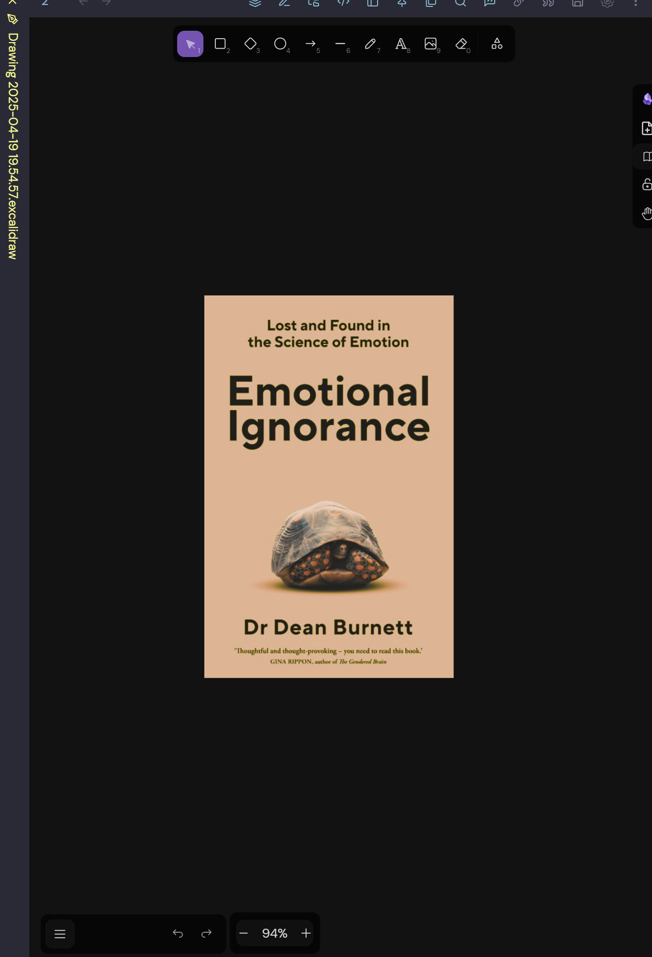

If I switch to Dark Mode (Shift+Alt+D) the book cover is washed out due to dark theme inverting images.

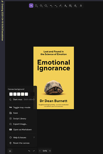

When I launch the command palette I can now revert the image to it’s original colour but preserve the background color #121212

This fixes the issue however now Light Mode becomes Dark Mode
When I reload Obsidian the script reverts back to Dark Mode (as that what my theme is set to and I have to select light mode to get my colors showing correct again

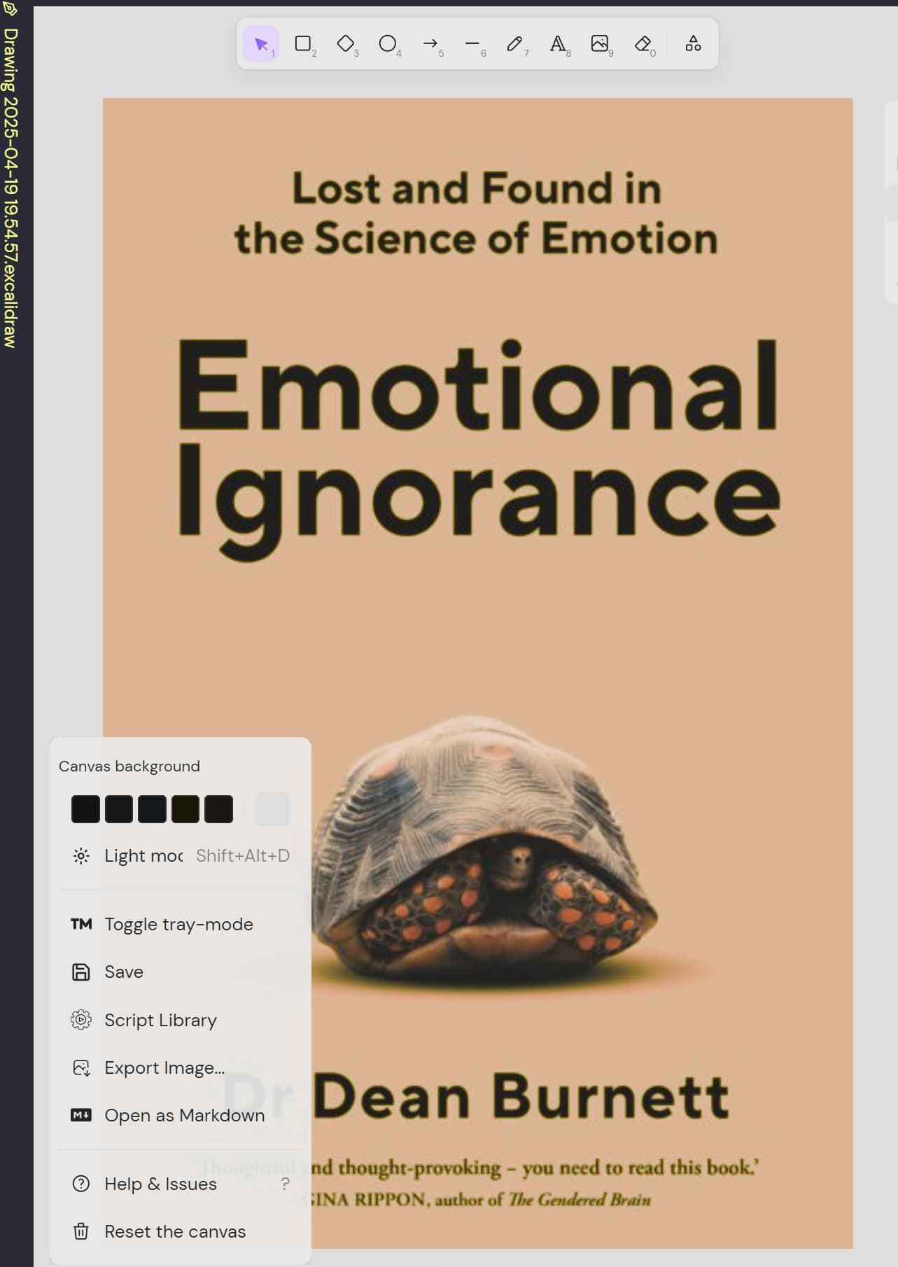

So this little script hack showing light mode as dark mode is a Technical Limitation, not a Script Bug from what I can see.
  • The “Light” is shown in the hamburger menu, but your custom dark mode is working with the book image showing the correct colour.
  • I would appear that I can’t fix the UI menu label without changes to Excalidraw core which I dont want to do.
  • As far as I can see the script is correct and working as I want it too.

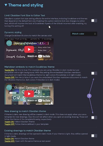

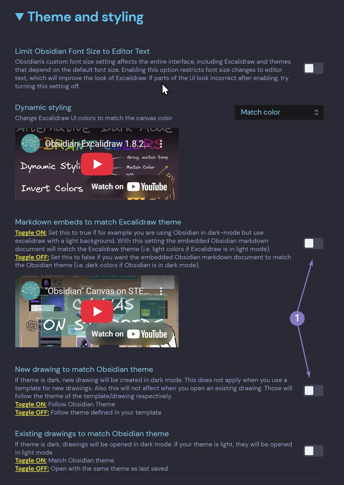

It’s was annoying to have to toggle it back each time I launch Obsidian but I got around this by changing these two settings in Theme and Styling
