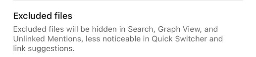

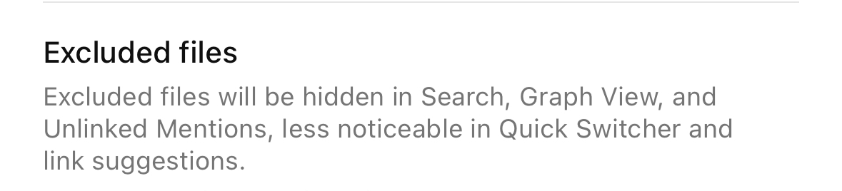

Settings > Files and links → Excluded files

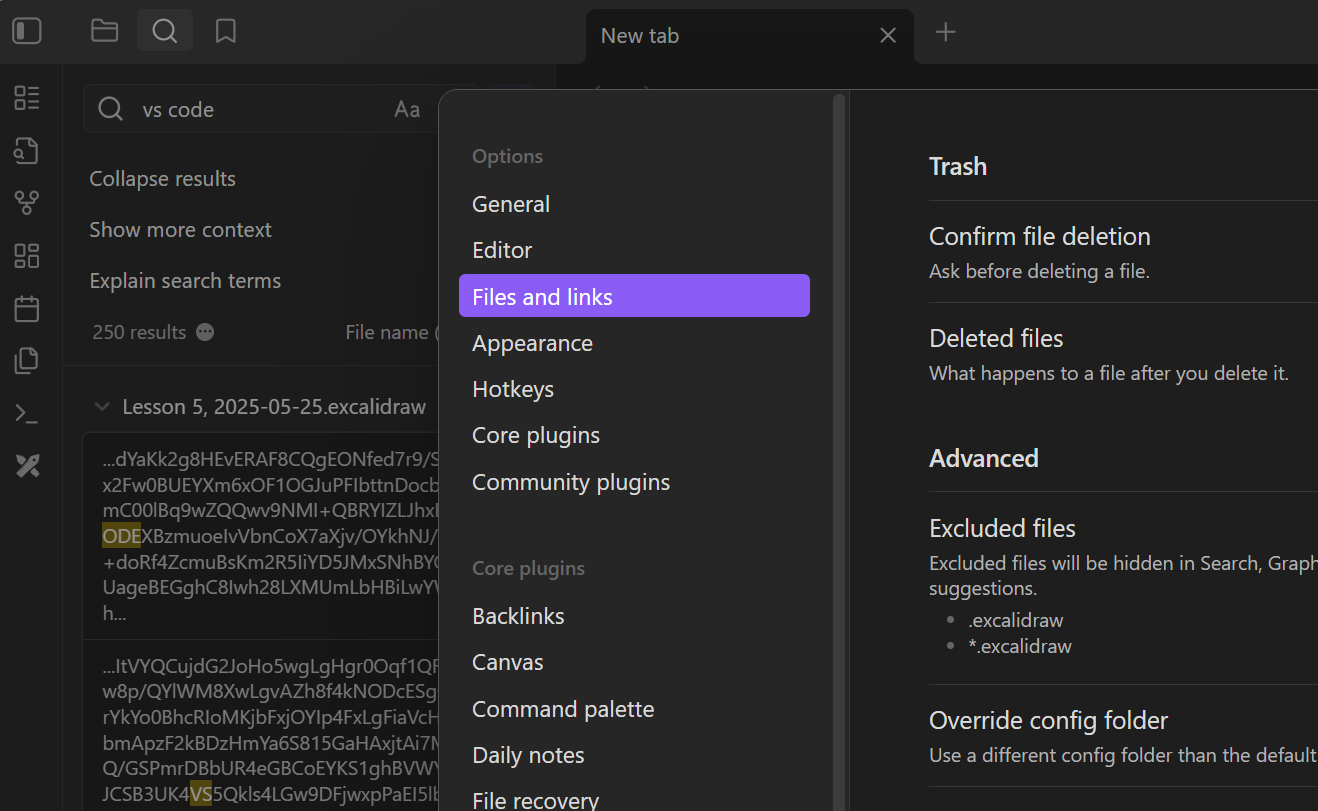

I tried both .excalidraw and *.excalidraw filters, and it just doesn’t work for me: drawings’ garbage still appears in the search results even after restarting Obsidian app. Is it a bug, or am I “holding it wrong”?

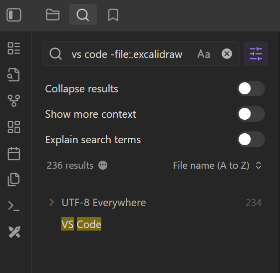

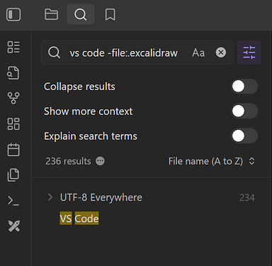

Meanwhile, -file:.excalidraw inline filter works fine.
Excluded Files doesn’t support asterisk wildcards. I believe this regex should work:
/.*\.excalidraw$/
This didn’t work for me. I have restarted Obsidian. :clinking_glasses:
Can you describe “didn’t work” in more detail?
