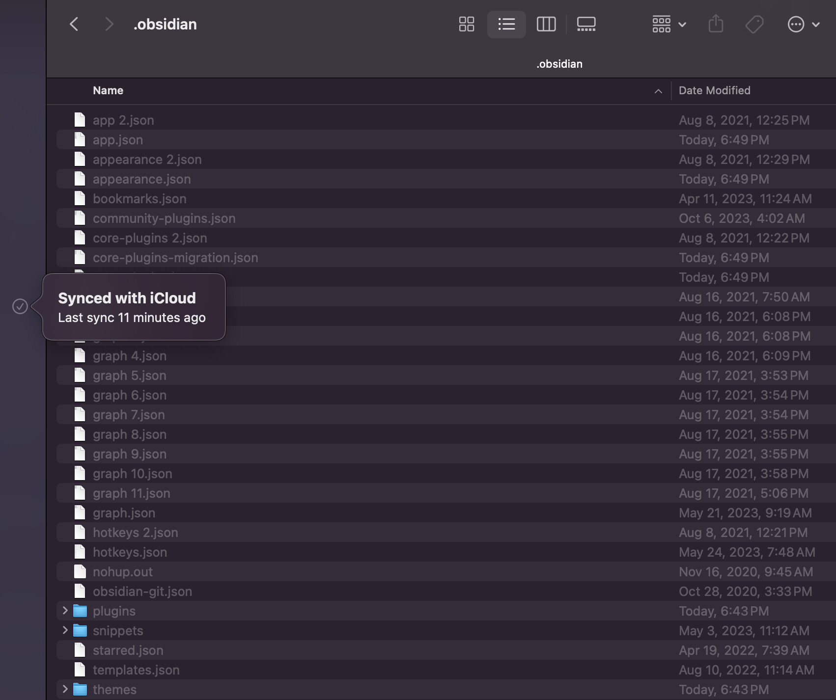

I sorted the files per Date Modified
All the folders are showing my old stuff. I don’t understand why obsidian is missing the folder.

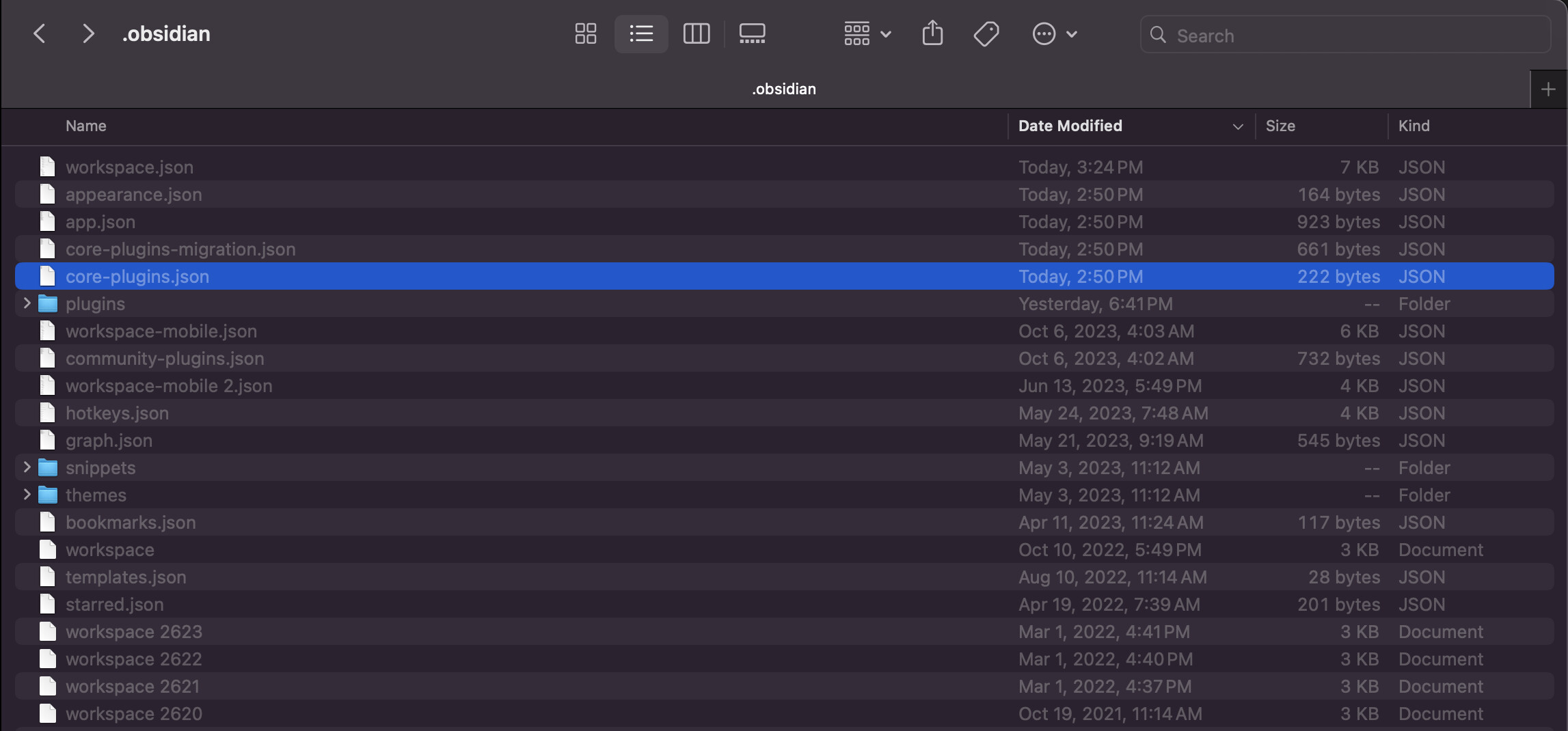

This is obsidian with another theme as usual as showing that the plugin is not active:

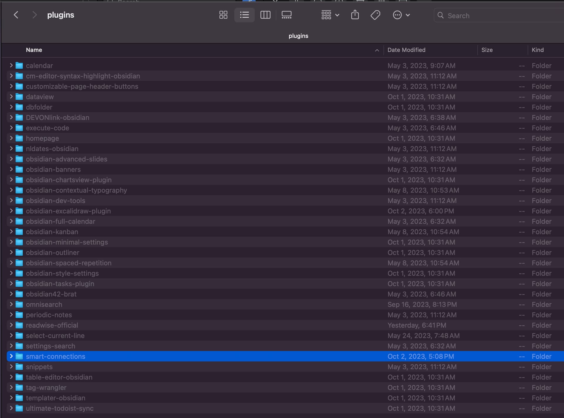

The “missed” plugin is here:
I would copy your whole vault over to a different place on your drive and open that copy and see if it works. Also right click on the header to turn on the iCloud Status column and make sure its all downloaded. If you copy it it will force a download anyhow but I’d stop messing with the iCloud copy and get a fully local copy working first.
Then I’d go into settings and see if the plugin is installed. If its not its likely missing from the community plugins JSON file. “All the folders are showing my old stuff. I don’t understand why obsidian is missing the folder.”. If some plugins are loading and some aren’t likely you’re going to find them missing from that JSON file.
Agreed - it could just be the screenshot - but everything looks greyed out which could mean it’s not downloaded from iCloud.
Thank you !!, I just closed Obsidian, zipped and renamed the folder, opened back Obsidian, select the new folder and everything is working like usual.

I expect what happened was everything just wasn’t downloaded. Zipping it would have forced a complete download of everything.
Honestly if you’re a heavy user of iCloud Drive turn on that status column in Finder.
Also the thing to remember is that iCloud will remove stuff to make space so if a file isn’t updated in a long time (likely for some of the stuff in the .obsidian folder that wouldn’t get updated often) it might get moved out if space is required. Its one of the reasons I decided to just pay for Sync again which doesn’t have that problem (not to mention file versioning, etc).
