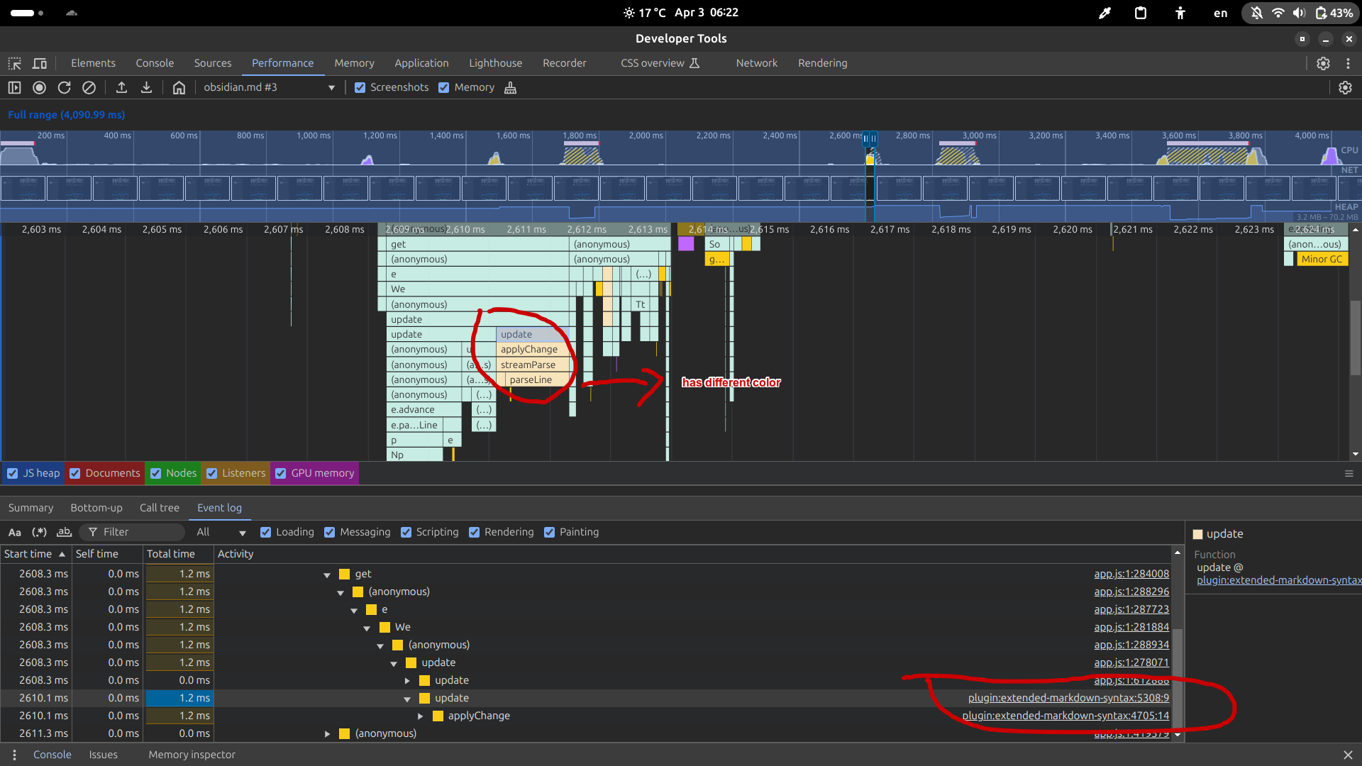

Here’s an example of how performance data looks.
In this example it took ~10 seconds to type a word (Obsidian by and large unresponsive with >80% system CPU
The performance degrades further with every heading rename, rendering Obisdian unasable after 5-10 renames.
I suspect this is always the case, but less noticeable with smaller documents.
I have the same problem
You still can track down which plugin that causes performance bottlenecks.
Distinguished by different color in the waterfall.
