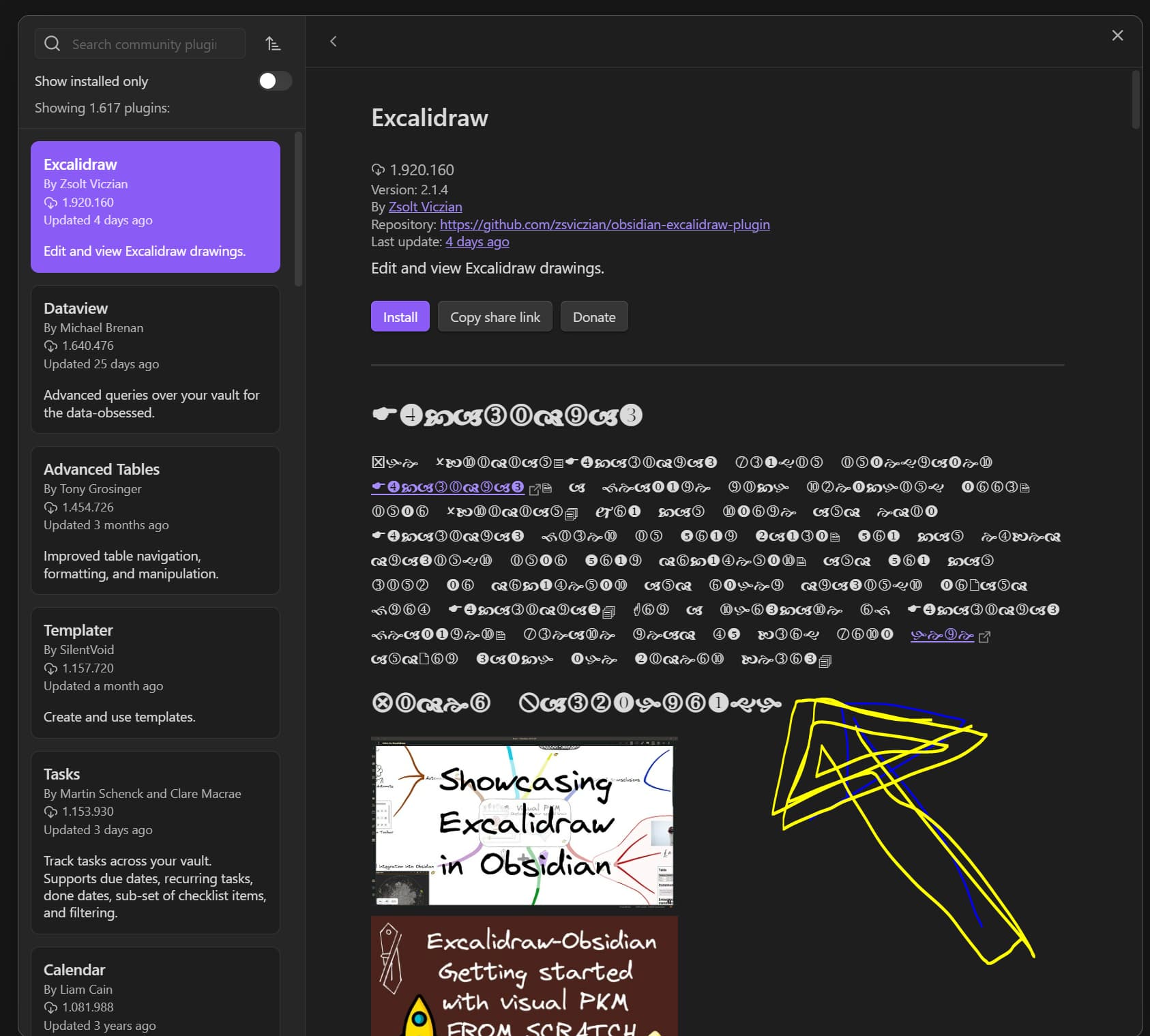

When using html on notes or browsing into plugins there are erros in formats.
How to solve it?
the unformated contents are in all notes. not only html content as said.

not. Only installed. The first use it was ok. Later started this error. I am using windows. I tried to reinstall but it was not possible full uninstall and after reinstall all thing stay the same with error.
how to investigate?

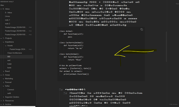

Important aspect @ariehen :
Code block is working.

As WhiteNoise originally said, this looks like a font issue.
The font used for code blocks is different than the font used for the main / body text. The font for code blocks is the Monospace font.

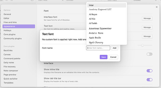

Try changing the Text font font here:
Though this seems like a Windows OS font issue.
Worked. Thanks a lot.
