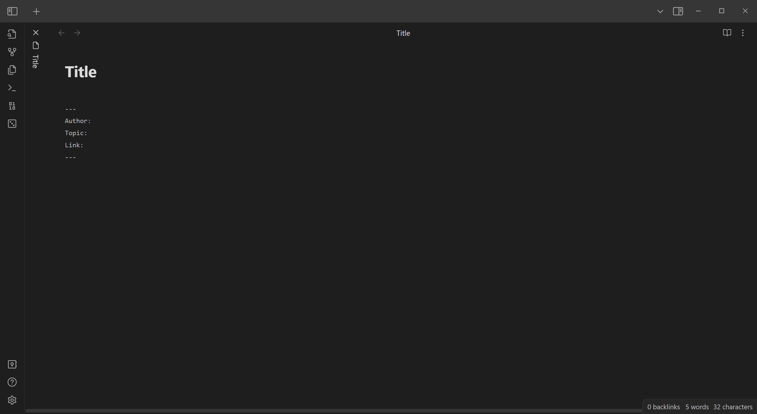

When I switch to “reading” mode the last line written in yaml mode has a different color. Has this ever happened to any of you? Do you think it can create some problems?
Try adding a space after the colon of Link: and then viewing in reading mode.
Yes it works, thanks! Do you know the reason for this error?
YAML keys are separated from values by a colon+space, so I assume that without the space the key isn’t clearly defined, causing what we have both seen in our vaults.
