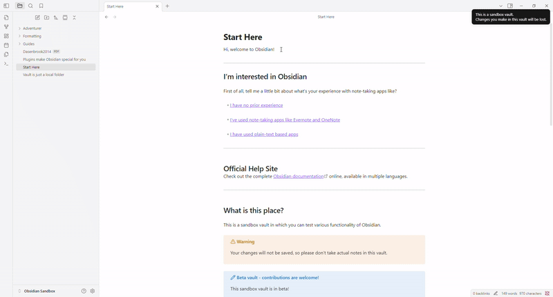

Erroneous focus on embedded PDF upon reload
  1. Embed a PDF at the bottom of a Obsidian page.
  2. Type the double-dollar $$ math $$ environment, and Obsidian will erroneously focus on the bottom-most embedded PDF, jumping away from the math environment.
  3. Alternatively, open some Obsidian file which has a PDF embedded at the bottom, and Obsidian will skip to the PDF.
Yes, the bug is fully reproducible in the Sandbox Vault.
Obsidian should stay at the current cursor position
Obsidian jumps to the PDF it loads last
Obsidian version: v1.8.9
Installer version: v1.8.4
Catalyst license: none
See this screenrecording for how the page focus occurs.
gif_report
