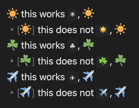

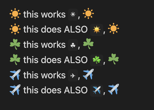

- Add custom CSS style with the code provided above
- Create a Markdown file an paste this content:
- [☀] this works `☀`, ☀
- [☀️] this does not `☀️`, ☀️
- [☘] this works `☘`, ☘
- [☘️] this does not `☘️`, ☘️
- [✈] this works `✈`, ✈
- [✈️] this does not `✈️`, ✈️
All lines properly interpreted as tasks:
BMP symbols work fine, any other emojis don’t:
