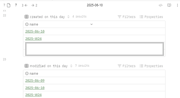

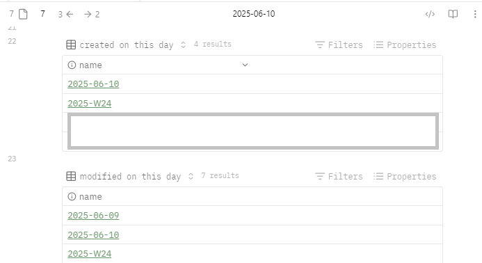

I initially misunderstood and was in a rush, but wanted to post more. This:
Guapa and Kaleo got it, but for anyone else interested: instead of creating multiple ```base code blocks in each YYYY-MM-DD daily note, create a .base for embeds (or add these filters as different views to an existing .base; it doesn’t matter).
For example a bases-for-embedding.base with this content:
views:
  - type: table
  - type: table
    name: created on this day
    filters:
      and:
        - this.file.name == file.ctime.date()
  - type: table
    name: modified on this day
    filters:
      and:
        - this.file.name == file.mtime.date()
When looking at the “created on this day” or “modified on this day” views in the .base itself, nothing should show up but with these views:
![[bases-for-embedding.base#created on this day]]
![[bases-for-embedding.base#modified on this day]]
embedded in a YYYY-MM-DD daily note, you’ll get results for that day.
※ Not 100% reliable because we’re using ctime and mtime here, but should be fine for most folks.

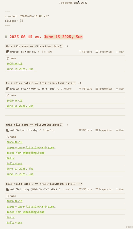

A bit of an update:
A member in Discord asked about this, but was using MMMM DD YYYY, ddd as their daily note format which the above won’t work for.
@purple penguin shared a solution that looks good, no matter the host note’s name/format:
  • created on this day: file.ctime.date() == this.file.ctime.date()
  • modified on this day: file.mtime.date() == this.file.mtime.date()

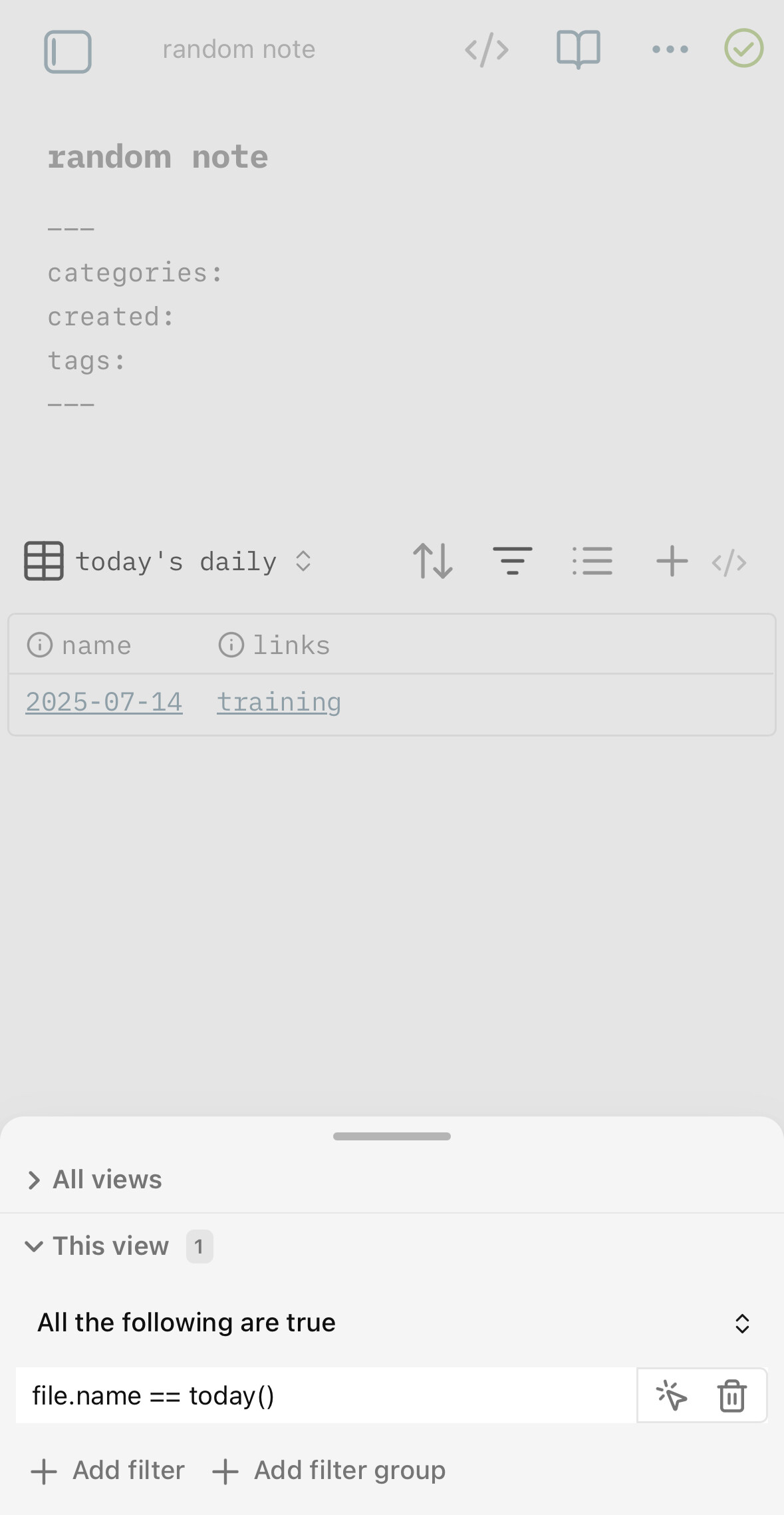

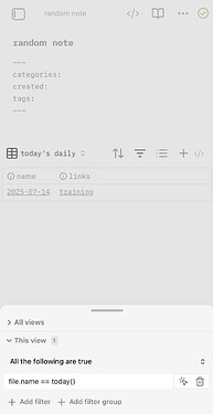

How can I embed a base that only includes today’s daily note?
Embed it in the day’s daily note and only reference itself?
file.name == this.file.name
Thanks! But I was hoping to embed in another note besides the daily note.
Assuming a daily note of the format YYYY-MM-DD, you could try file.name == today() e.g.
```base
views:
  - type: table
    filters:
      and:
        - file.name == today()
    order:
      - file.name
      - file.links
Thanks! That was what I needed!

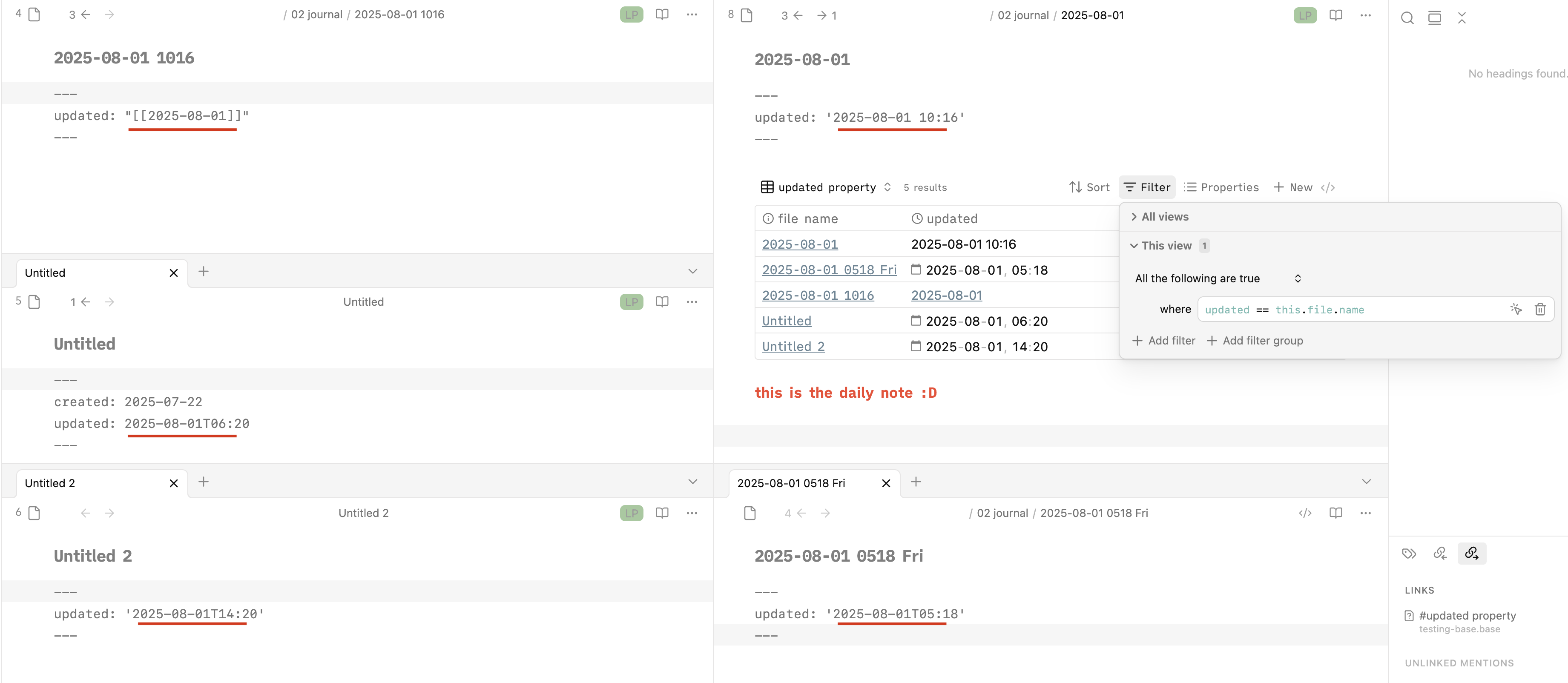

I’m using the following filter formula to get notes:
note["updated"] && this.file.name == note["updated"].date()
It works perfectly, yet every time I open my daily note the following error pops up: failed to evaluate filter, can not find function date() on type string
What am I doing wrong?
Hi @Kaleo
Hopefully some Aces of Bases can jump in (thanks Cawlin :wink:), but a few questions that may help folks help out:
  • The goal here is to filter notes that have the same updated: (property) date/time as the daily note that the ![[embedded.base]] is in, is that correct?
  • What’s your daily note file name / format? e.g. YYYY-MM-DD?

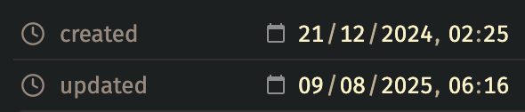

  • What format is being written as the updated: value in notes? e.g.
    • updated: 2025-08-01
    • updated: 2025-08-01 10:16
    • updated: '2025-08-01 11:02'
By chance, do you happen to have an updated: that looks like
updated: '2025-08-01 10:16 Tue'
You’ll see failed to evaluate filter, can not find function date() on type string with something like that, but that note won’t be returned / listed in the base.
Correct! The daily note format is 2025-08-09, so exactly like you expected.
It looks like:
updated: 2025-08-09T05:18
Which is managed by GitHub - lighthousedino/obsidian-front-matter-timestamps.
EDIT: it looks like this fixes the evaluation error
note["updated"] && date(note["updated"]).format("YYYY-MM-DD") == this.file.name
Glad you got it working!
I don’t think I have any datetime Properties like 2025-08-09T05:18 (with the T) in my vault. I’ll need to look into using that format.
Also, a filter of updated == this.file.name seems to return the correct notes in a variety of formats with a quick test:
I guess the benefit here is that this format is recognized as a proper datetime value?
Wow u’re right. So simple and it works. I let my brain do too much thinking here I guess. Still getting familiar with all the possibilities!
